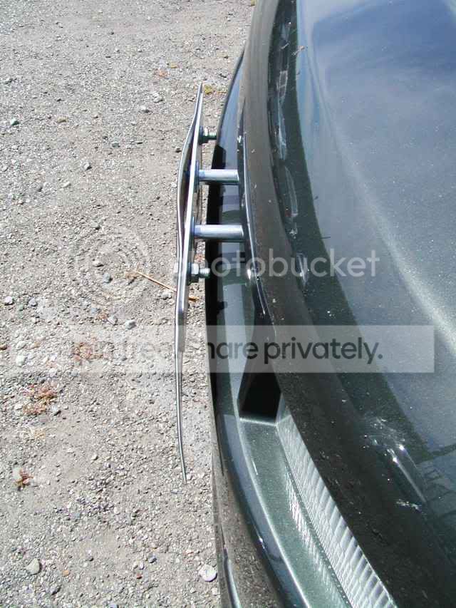

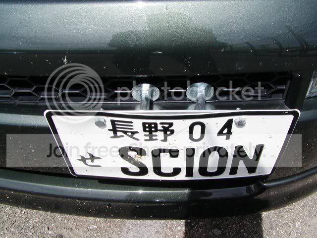

I finally made a bracket for my front license plate. I was lucky enough to get my Box without the bumper getting screwed. I've been wanting to make something that would incorporate the "Nor*Cal mounting" look but with a little more refinement. Here's what I came up with.
Items needed: (I purchased all items listed at Lowes)
2 - 4 or 5 inch 3/8ths carriage bolts (I used 5 inch, maybe a little longer than needed)
4 - Large flat washers ( I covered one side of each with vinyl sticker for scratch protection)
2 - smaller washers (fender washers ?)
2 - 1.5 inch steel spacers
4 - 3/8ths nuts ( I used two regular and two with the locking plastic ring inside)
OPTIONAL: Mounting bar (I used some flat aluminum, NOT fun to work with)
I say the mounting bar is optional because you could just use the bolts thru the license plate holes and mount it straight up that way.
Drill holes in the mounting bar and dremel or file holes to accomodate square part of carriage bolt head. Insert carriage bolts, put small washers on the bolts. Follow with steel spacers and regular 3/8ths nuts. Tighten nuts to hold carriage bolts and spacers in place. Add one large washer to each bolt. Insert bolts thru honeycomb at desired location. Place large washer on each carriage bolt behind honeycomb, follow with locking nuts. Tighten deez nuts until it sandwiches the honeycomb between the large washers. Add additional nut to lock if desired.
You should end up with something like this:
The reason I wanted the bar was originally so I could swap between my Cali plate and my JDM looking one when needed without having to take the whole thing apart. As i got down to the end of the project, I used two LED lighted bolts for the plate. It looks good except that It's not going to be easy to hide the wiring with this bracket and by running the wires thru the holes, it makes it hard to quickly swap the plates. I may have to rethink the lights on here...
Anyway, hope this helps. I planned it all out as I was browsing thru Lowe's. Hopefully this will help someone else save some time. I thought about making a kit, but with the weight of these little things, it'd probably cost more just to ship than to buy the parts locally.
Please feel free to refine my process here too...

I haven't mounted mine but you can basically put it anywhere along the bumper. I like the "to the side" look, but i will probably center it in the middle for symmetry and balance.
This is basically where I got the design idea, but they put the bolt heads behind the grill and have the threaded end going out the front, whereas mine go the other way. I'll try to get a pic of mine when I put it on.

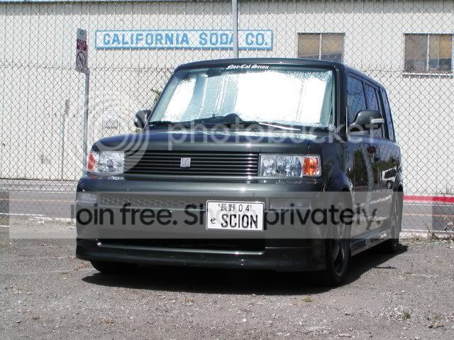

Finally got it mounted for BOTI -
The arch on top is intentional to keep it stiff, otherwise the plate wants to flex at diagonal corners...

Its a great place to install it and it doesn't rub the bumper either. And you can see it complimants my front lip too!!

:oops: :oops: I know I know. That was right after the drive back from Bakersfield and I was following EvilDave the whole way so he killed more than me. But when I was going down solo I massacred a zillion bugs...
On the plus side tho, look at the first picture. From 10 feet away you can't hardly tell there's bugs on it.
