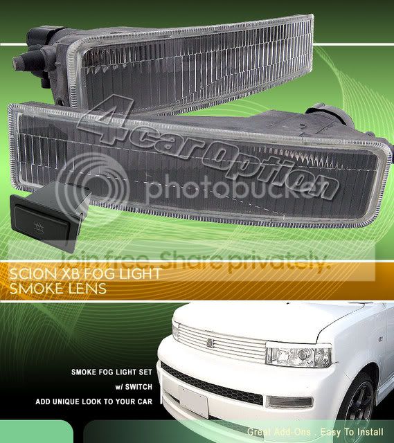

Default Ebay xB fog lights???
Anyone purchase these yet? How was the quality? Worth purchasing or stay away ? Let me know really want to buy a set.
[/img]
Old Mar 27, 2008 | 04:50 AM
burstaneurysm's Avatar
Posts: 11,312
From: Forest Park, IL
They work, but they need a relay and the switch needs to be modified to fit the stock wiring harness.

I bought a pair and they look good, but the clips used to put them on were too small. I'm gonna have to invent something to put em on, unless someone knows where I can get those clips.

yes, those are the clips. so just to reinerate:
1. you'll need a relay
2. you'll need 2 sets of clips
3.you'll need to modify the switch wiring/switch or buy a new factory switch
4.there is a probabality that one of your fogs lights will be broken somehow: either the glass will be chipped or cracked, and or you may be missing a screw/screws on the back where the bulbs go in.(many people experienced this including me)
i know this because i have a set of these ebay fogs, they were a pain but i did evetually get them to work, it may be easier for you to buy the factory ones, but in the long run you may save some money with these. good luck

how did the clips work out? i have the same problem, they arent very sturdy in the slots because the clips are too small
