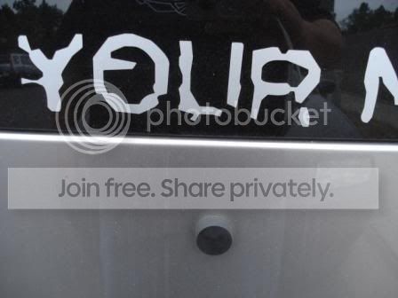

I do not know how many times I see a post about how to remove the lil tabs that hold the inside hatch panel on.I removed my wiper today using pair of scissors, 10.mm socket and ratchet and a rubber plug i got at home depot till i get enough scratch to do the full shaving of my hatch! Hope this helps! I figured i'd put my 2 cents!
1 find the lil.bastard
[/img]
2 take your scissors and put each blade under each side of the tab
be gental
do not cut it off, lol...
3 gently pry off
and it should come off like this
4 repeat on all tabs and then you will have the cover off!
i found these worked better than the scissors,
i have used both without losing any tabs on 2 boxes!
the rest is easy there are 2 10mm bolts tha hold the motor for the wiper in, and one that holds the wiper blade on! remove those and u will just unclip the quick connector and u are good 2 go!sorry for the lack of pics, it got dark and i was working on the street! plug the hole put it back together and.......
no more wiper!
