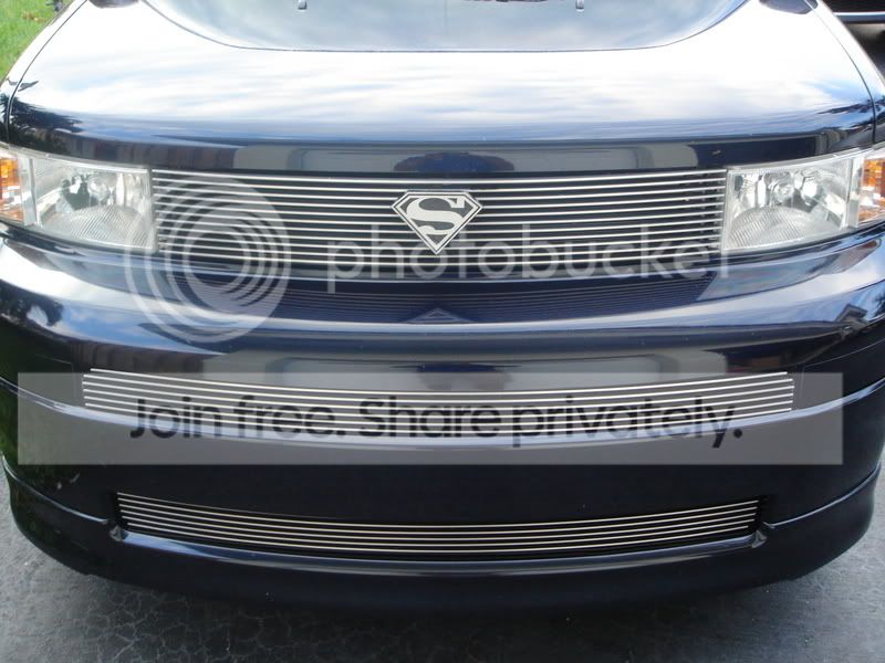

my friend just got a grill for his xb but we haing problems gettin it on for the bottem and middle anyone can find a tech or know how already! need help asap

don't have any pictures.......but we installed the grillcraft mesh grill in my GF's car.......you have to take off the front bumper completely......Middle and lower grill remove from the inside. they clip into the front bumper. After you remove the stock upper grill there are two 10mm bolts and a plastic clip(like the 3 for the grill). in the fender well you have to remove the forward two 10mm bolts one in each wheel well(the ones attached to the bumper. there are 4 10mm(?) bolts for the plastic liner under the lip that need to be removed to remove the whole bumper.

please let us know which grille you are referring to (pics help) so that we can be sure how to help.
three pop rivets in the top of the grille. one on each headlight, and one on the latch assy.
teeth on the bottom of the grille hook into the headlights. very easy.

mine went on top of the stock one, i secure it with wire ties

Nice emblem.....
