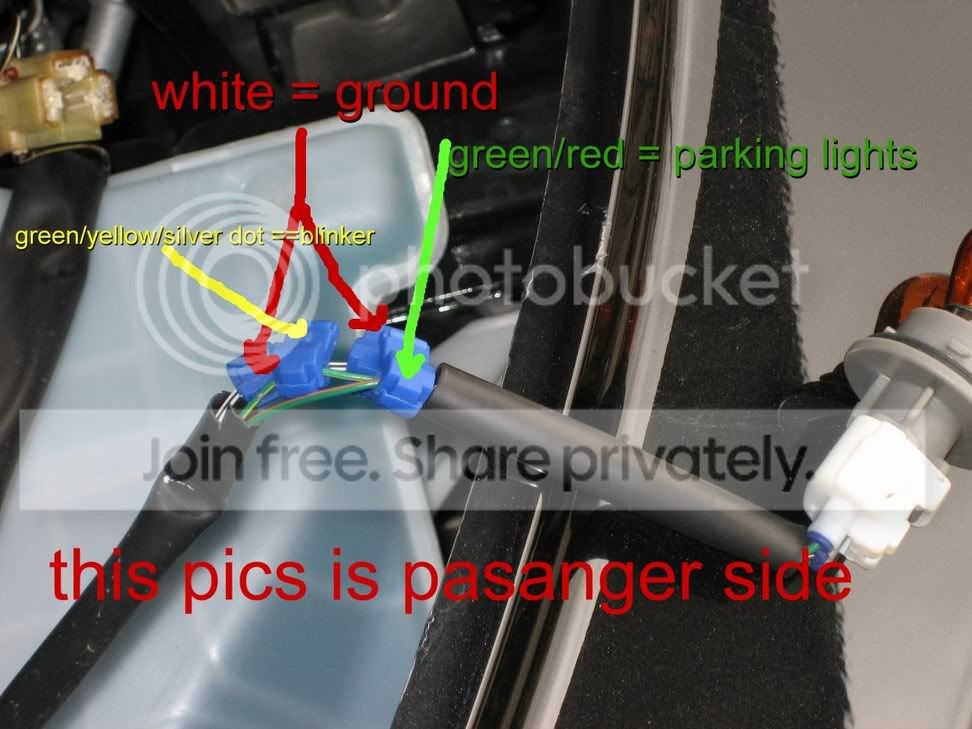

Old Aug 14, 2005 | 06:10 PM
jaimecosio's Avatar
Posts: 326
From: extremeautogpx.com
some pix
Old Aug 14, 2005 | 06:29 PM
jaimecosio's Avatar
Posts: 326
i wired the halo to the parking lights and the LEDs to the blinkers
