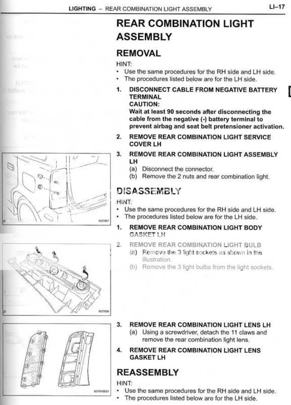

here u go

ur welcome and its kinda hard to reach the 2 bolts needed but its very possible. first unhook the middle connector and the those screws will be easier to get off.

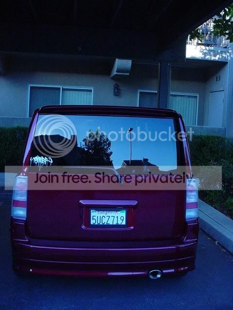

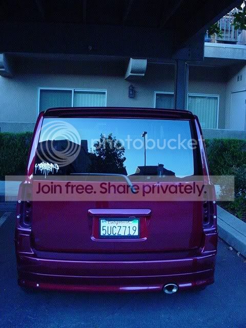

hey, so here are the final pics!!! how do you like them??
Old Oct 28, 2006 | 11:23 PM
1epoXyBox's Avatar
Posts: 701
From: L.A.,CA
Lookin good!!! You'll love em!!!
Old Oct 28, 2006 | 11:24 PM
alibuster's Avatar
Posts: 40
thanx i already love them to death... and they're hella bright at night
