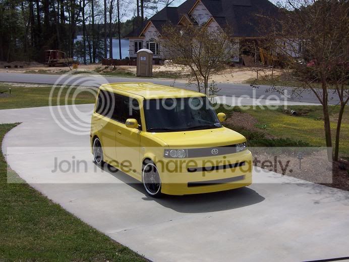

Just put some Dual Projectors in with halo's and LEDs *pics*

the arms that branch out that you put the screws in were less than perfect. Had to stretch them out a bit. The corners if you're not careful will rub up against the fender and chip the paint off. The lip on the side of the housing that the front bumper goes over was too large, had to trim the corners off, then had to reset the bumper. the sides against the fender will stick out if you dont have someone (idealy 2 friends) holding the sides in while you tighten the top mount bolts on the bumper. The bulbs were tough to put in, the turnsignal assembly reguires a bit of "persuasion", etc

Hey if they seem to fog on you one day, let them dry out & give the bulb plugs a good tight twist. They seem to loosen just a hair over time & it is enough to make them fog. Just a Tip.
I see we have a few things in common, the lights & the OTG sticker. Good choices LOL !!!
I switched my lights though to the RS-Type / Ichiko style headlights. I like these much better !
Here is an old pic from last season, October I think. Oh well it doesnt look like that any more !!!!
