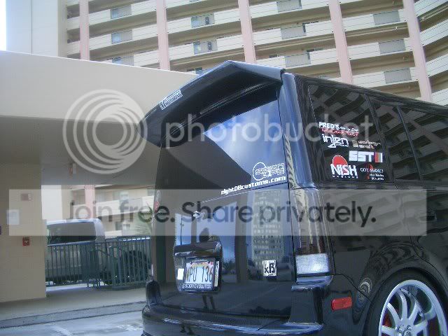

I will go step by step on How to remove an Old CF Fab wing to installing the New M2motoring wing..
Why did I Change out my wing??
The M2Motoring wing is very will made and every detail has been taken to make sure this wing provides customers with 100% Satisfaction. One of the high lights of the M2Motoring wing is is that the seam is unnoticeable. And I wont get asked why is the wing like that with that seam.
I hope this topic will help make the install of this wing easier!!!
Anyone in intested in purchasing a wing contact M2Motoring.. if you in Hawaii I have them in stock!!! and no need to wait for it to be shipped!

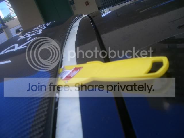

This is the old wing that I had one for over a year!!! It was Stuck!!! Double sided 3M outdoor tape sticks very well!!
I used masking tape to mask off the paint so I dont scratch it when cutting old tape..
Next is to use a credit card or a plastic spreder to cut the Tape.. just take your time.. I used some WD40 to make thing slide more easy..

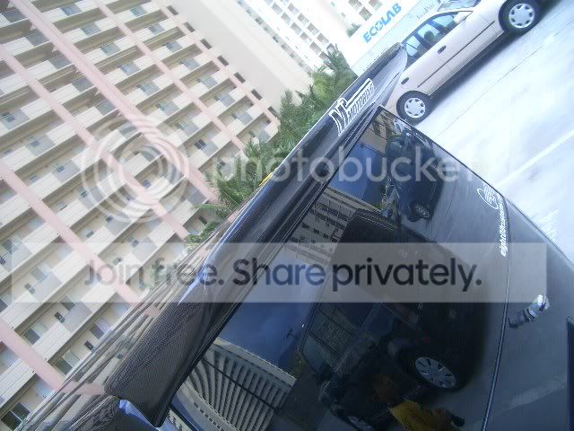

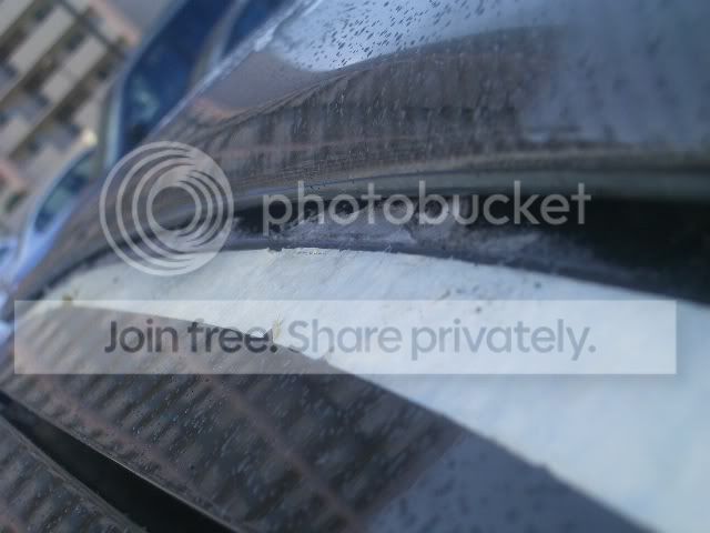

After working down the wing and cutting the tape.. you can winggle or pry the wing off.. Now the hard part is next.. Due to the wing being on the car for over a year and having the tape set in hot sun.. there going to be alot of goo stuck on the car.. Use Goo Gone, Accetone, Wax and maunal labor with your fingers to remove all Goo..
Now that the old wing is removed and all the goo gone! Now either use alcohol or accetone to remove oils and wax so that the tape sticks..

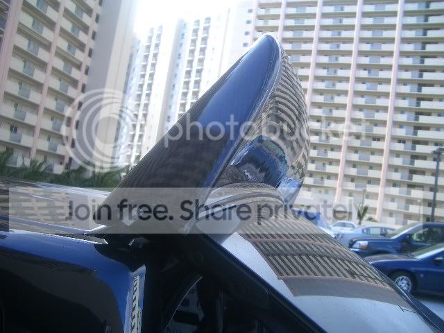

Now what I do is mark center using masking tape.. mark the body and the wing for center.. this makes it more easy to line up..
Now wipe the Wing, where you will apply the double sided tape with Alcohol or accetone.. and apply the tape... test fit to see were you might have to double up onthe tape and add onemore layer...
After you have test fit no remove the backingon the tape and you pretty much have one try at this.. so make sure you line it up right.. just stick the bad boy on and install the clips..
Now your Done!!!
