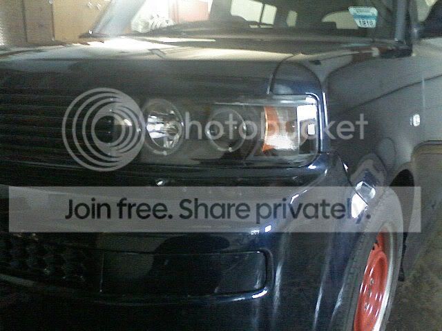

My .02 cents on the Sonar projector lights.
I just picked them up for a little under $100 new.
Using 9005 GE Night Hawk LO beam lights (converted from 9006 bulbs)
H1 HI beam bulbs (not worth using cause the aim is poop)
1157 Silverstar Turnsignal bulbs. (These things are super expensive but look nice. I think they go for close to 15-20 dollars for 2)
Fitment was right on, minus a small unnoticable gap around the edge that meets with the fender. The aim needs to be adjusted a little down but I also did a 9005 conversion with wire harness plug change out. Hi Beams are worthless. Aimed lower then the Lo Beams and to the left. Not complaining cause the Lo beams are plenty bright. Wiring was simple enough, just took a little time. All together probably an hour or two install for beginners.
The beam pattern is a little scattered compared to the stock lights, but it's not too far off. The beam is also more centered. I don't see the sides of the roads as much as I used to, however the beam goes farther and is much more clear then the stock. I might still need to make a few smaller adjustments. UPDATE: after adjustment the LO beam pattern is not as scattered. Lighting is still close to stock minus a little less light on the sides and cut off is perfect.
They are Dot approved as per stamping on the lenses. I checked the seal and it looked ok, however some places looked sealed better then others. My recommendation is to put a small bead of silicon around the edge of the headlights and wait a day before install. Since I'm impatient I put them on right away. lol I put them on last night and there was no indication of fogging. This morning was rainy and cold, still no indication of fogging. So far so good I hope it stays that way.
On a sidenote I noticed that the OEM headlights have the same plugs in the rear, for breathers, of the assembly. Only big differences were: Two large ones on the OEM v. three smaller ones for the Sonar and the placement. The OEM headlights are capped BTW.
If anyone want's to know about the 9005 conversion, because HID's are too expensive, search the tC forums it's a hot topic over there. I would recommend getting the Sylvania SilverStar 1157 light bulbs to complete the look.

Little update.
no fogging since I put them in. High beam aim is still poop but I think I might be able to adjust them, just been lazy. Aim on the headlights took three days, only cause I'm **** about that stuff. Otherwise things are fine and dandy.
