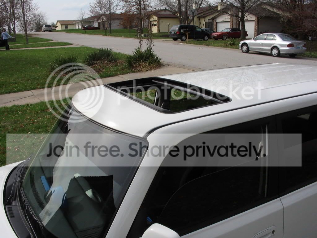

id say its way too low.
this is the closest pic i could find of mine

nope, no scratches, just dusty. Thanks for that pic swartz, that's exactly what I needed.
