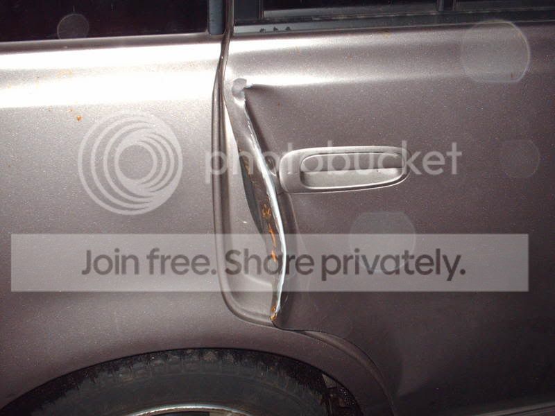

well today, my sis was backin up and my dad opened the door at the wrong time and the tree jammed the door so badly that I do believe that we need a new door.
well, I can't claim this on the insurance so I am goin to have to find a way to fix it myself or go to the body shop. Before goin to the shop I would like to know the price of a new door.
So I'd like to know where I can get this info before goin to the body shop.
btw, here is the damage:

have you inspected the hinges and b-pillar for damage yet?
contact the dealership - they can price the door for you, and if you're going to a body shop, that will be the most comparable price.

Yup you need a door...used door if you can find one may be a good deal...and you might need some repair to the hinge post. You may also need a latch...pics look like maybe there is some twisting of it??? If I was at work i could look up the door's list price...but alas I am at home now:/ In order to replace the door and have the color look consistant (match) along the side of the car they should paint the front door,nad blend paint the rear door and 1/4 panel. if you get a new door you will also need the pieces on black plastic vinyl transfer (3) for it also the are $50-70 each so 150-200 just for those...I would bet the door itself lists for between 350 and 600. Get the pricing from bodyshop and dealer perhaps and then look for used parts (if the BS/ dealer couldn't find used) if the used price is $150 or more $$ less than new parts (new door plus plastics and maybe latch) go used. (you must remember that using a use door takes more labor (dissassmebly for paint and transfering your exisiting parts...or did you want that junk in the used door the last guy beat on??) to do a really good job so that is why I said used must cost more than $150 less than new to be truely cost effective, extra $100 or more labor involved and for less than $50-75 difference you might as well have new I would think). Good luck.

went to my dad's friend and he said that the door can be stretched out and it will look good as new once painted. Do you think this is possible?

That door should not be fixed. it is too far compressed to be "stretched out" and have the integrity of the skin to the shell of the door be anywhere near like it should be. I AM at my shop now and the new doors lists for $436.27 from Scion. If the dealer is saying the price of the door is $500 they are marking it up. If the bodyshop you went to was actually charging you $800 for the door itself they are ripping you off. My estimating system gets updated parts pricing data monthly and it is showing $436.27 list price, the labor to change the door is 4.6 hours, the labor to paint the door is 3.2 hours. The system allows for $83.20 in paint cost for the door (not enough if that is all that is being painted (cost will be more like $125 for the paints), but once you add in the labor times to belnd refinish the front door and 1/4 panel the system would likely allow enuf in materials to do the job (materials cost is based on paint labor hours times the paint allowance per hour which here in Atlanta is $26 per paint labor hour).
I ran an estimate and the cost of replacing the door with new parts with no blending of adjacent panels (labor rate $38 per hour with materials at $26 per paint labor hour) is $1107.97 with the door and the 3 pieces of tape for the door costing $560.73 plus tax and the rest being labor and paint cost. From my post above that means that a used door (if it is nice and not damaged) is a good bet if you can buy it for $400. adding the necessary blending for color match (right front door and 1/4 panel) and parts removal for paint access (including removing and installing the 1/4 panel window (a judgement call but I added it as to have a higher price rather than a lower one) comes to $1420.39. This assumes that there is no damage to the hinge post where the door mounts to the car. Hope this helps! Better luck!!!
