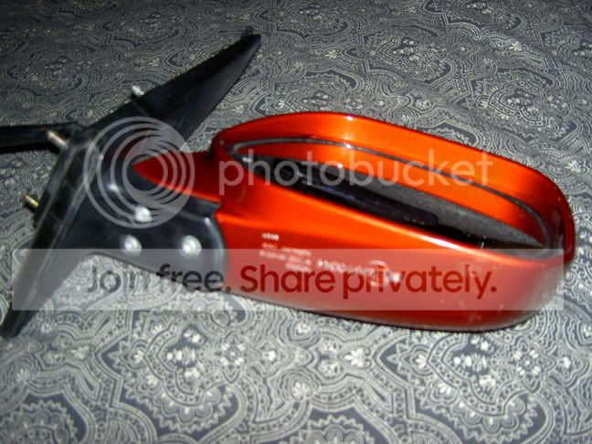

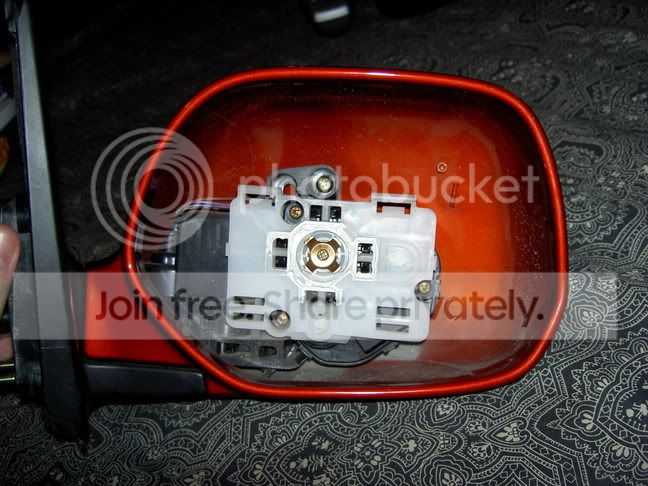

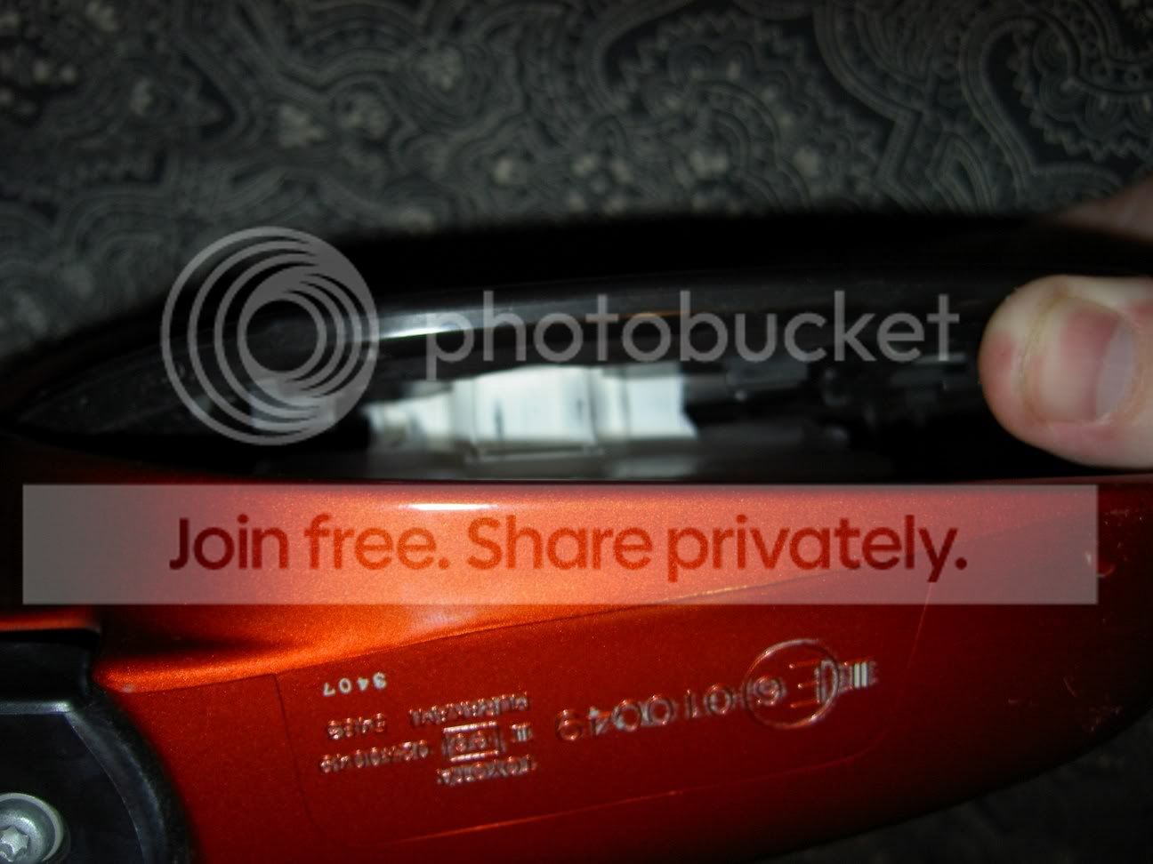

here are a few shots of mine...
does this help???
moved to drag co.

yes, kind of... How did you get to the tabs. Just push the mirror upward and work on that adhesive stuff? I see tabs, but don't understand there direction.

yeah, just pull from the bottom of the mirror. you can see the two clips and put a screwdriver in ther to help pry...
the adhesive stuff will strech a bit. just go easy, it takes a few mins to do each one...
