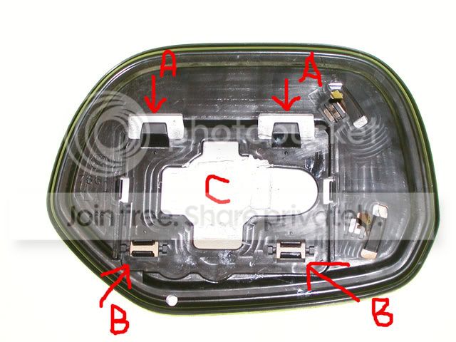

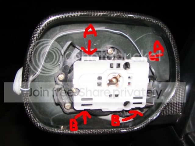

push the top of the mirror back to tilt it all the way up. Then use your fingers or a screw driver to pop the bottom the mirror out, (there are 2 clips on the bottom of the mirror and then the top hinges will just pull out.) Reverse the process to reattach the mirror.
Old Feb 8, 2006 | 05:36 PM
TheScionicMan's Avatar
Joined: Jan 2004
Posts: 5,736
From: In the Hot Tub
What Nick said. here's what it looks like.
Housing:
Back of mirror:

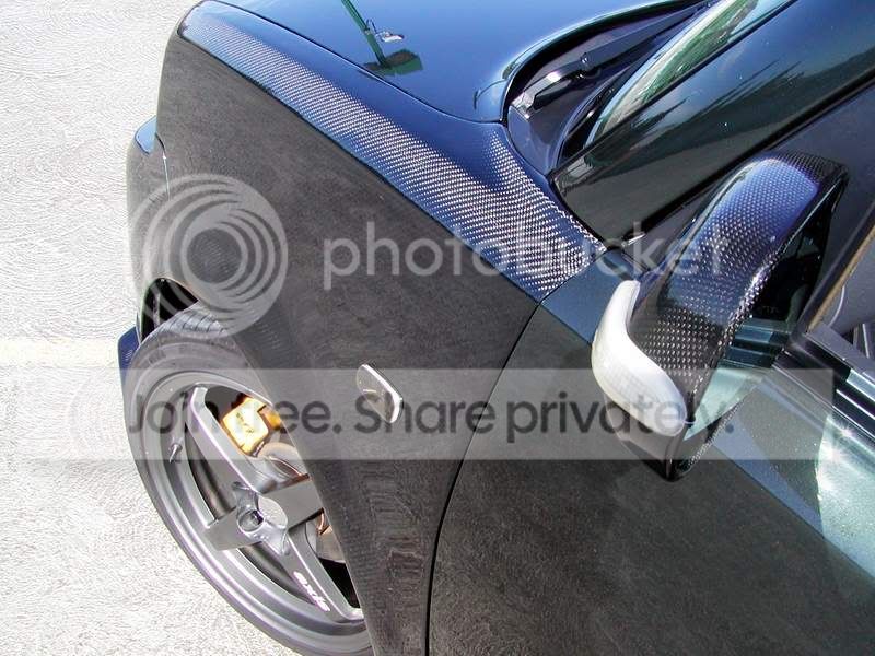

Housing:
Back of mirror:
how the he!! do you put those CF overlays on? are they the bBist covers?
Very carefully...
These are from www.carbigncraft.com. The turn signals were my own addition.
