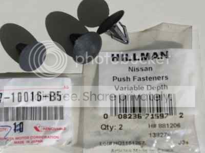

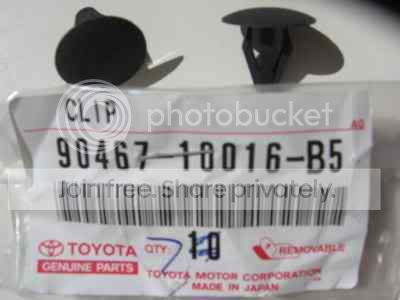

How about a cheap DIY?
Just ordered some plastic "clips" for the rear hatch trim panel...deadening behind there and some of the originals went DOA.
I got to thinking that these are just about right for my $#@* bumper that the dealer idiots drilled.
Painted them 068 Polar White touch up paint, drilled(!) the holes out to 1/4" and pressed them in. Not Bad! Sure beats the $24.95 a pair bumper plugs! Only $1.25 each.
As good as no holes? Noooo. But 100% better than ugly holes from 1/4" pan head phillips wood screws.
Now going to relocate the license plate!
Edit: Just returned from Lowes to buy bolts and washers. Found these, they are almost identical to the rear hatch panel clips-Toyota on the left, Lowes on the right:
A little larger OD, $0.80 for 2 pieces. There were two sizes...a 1206/these and a 1207/little smaller.
Just saw that cierrecart had already found these !! Now we have part numbers.
