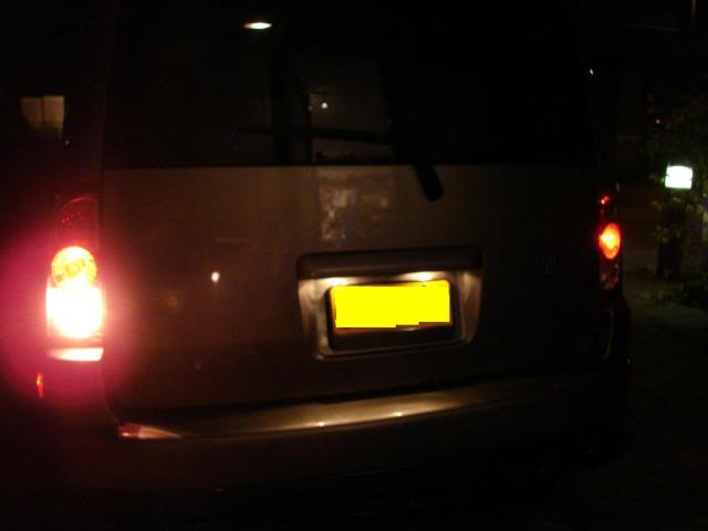

Old Jul 24, 2009 | 10:02 AM
metsvenand's Avatar
Posts: 80
From: UK
Here is a picture of the rear lights. Look at the bottom one, it has a red light bulb. That's the new fog light setup.

I am going to take some pictures this coming week of all the changes made to the car and try to make that write up.
