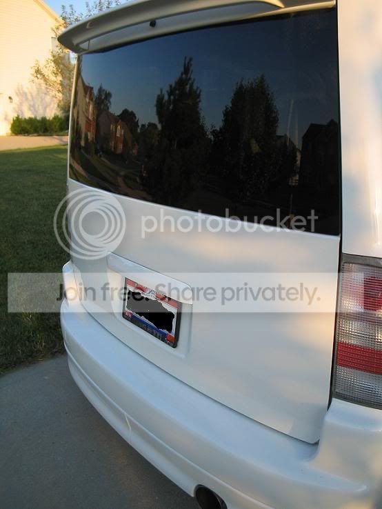

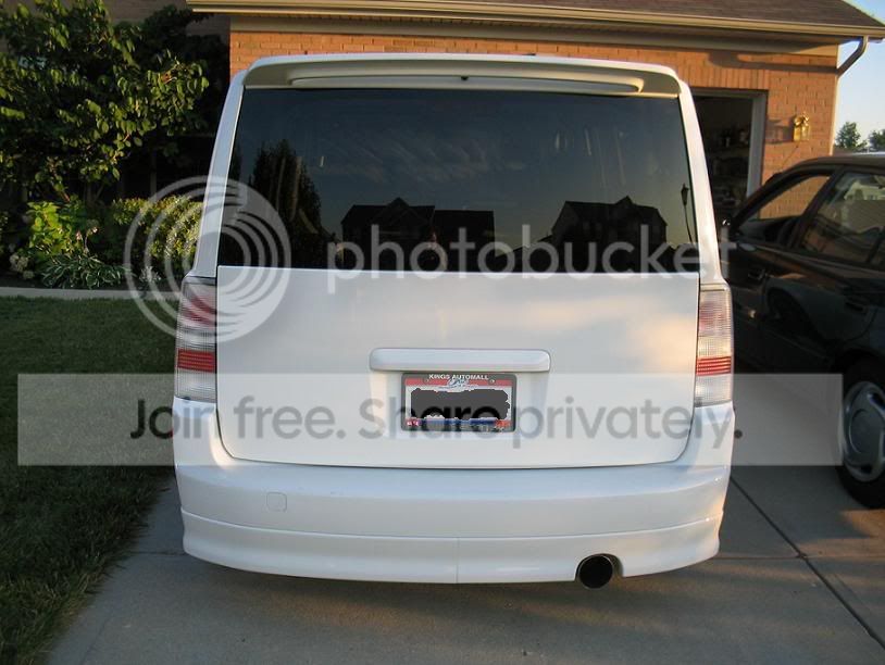

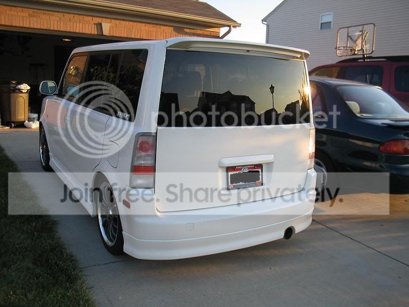

i shaved my rear wiper myself...it took 2 days to do
if you're gonna have a shop do it tell them that u want a the backing plate adhesively bonded instead of welded....if they weld it the heat will warp the panel

^ That looks hella clean!
did you have to paint the whole hatch?

i based the small area where the hole was then cleared the whole hatch
