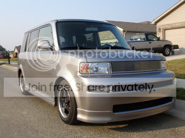

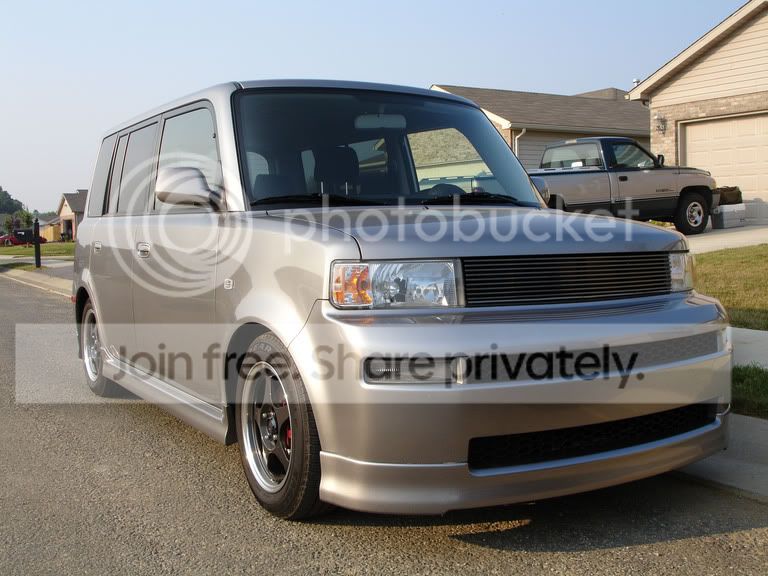

I have a billet grille on my TCM. It has black top and bottom of each bar, end the front is polished. Should I paint the front black? I probably should have gone slightly darker in photoshop, but I was worried it wouldn't look like a billet grille in the pics (like how the lower honeycombs don't show through.) Does anyone have any pics of black billet grilles?
Now, how to paint? First off, what level of gloss would look best? Does anyone else with a painted grille have any issues with paint chipping or flaking? There are no powder coating shops around, so I could send it off if a rattle can won't suffice, but I'd prefer not to.
Currently:
And with black:
Old Jul 12, 2005 | 02:53 AM
BEASTXB's Avatar
Posts: 295
From: Palm Beach, floriDA
keep it polished, it looks better with the car color
Old Jul 12, 2005 | 03:07 AM
lavabox's Avatar
N.G.S.O.
Joined: Mar 2004
Posts: 180
From: Atlanta, GA
Rattle can won't last a week. Powder coating would probably be best. I would think a close second best would be properly applied automotive paint over a good automotive etching primer coat. I would try to match the color to the lower grills or the wheels to offer a connection with the design. Another possibility would be to leave the top and bottom rung polished and do the remaining inner rungs black like your wheels. The upper and lower still being shiny will also serve to connect the headlights visually.
Old Jul 12, 2005 | 03:23 AM
UBOW's Avatar
Posts: 354
From: French Valley, CA
Ayup, paint won't stick to it very long. It will peel and flake off unless you etch and prime it first. Even with powder coating you will have to etch and prime first.
I suggest you stop by a plating house and ask them what you should do. They may be able to etch it any color you want, as long as it is bronze to black.
Old Jul 12, 2005 | 04:04 AM
Max's Avatar
Max
Posts: 4,971
From: Atlanta, GA
Hmmm. It looks like it's more work than I had hoped. I don't really like the generic look of the polished billet, and I am really loving the photoshopped image. Looks like I need a powder coater. Thanks for all the replies.
Old Jul 12, 2005 | 11:09 PM
UBOW's Avatar
Posts: 354
Acid etching will turn quality nickel plate into bronze. Stronger solution will turn it black. If the nickel plate is poor quality then you will have a mess. Consult with a plating shop. They will know which acid to use and what strength.
