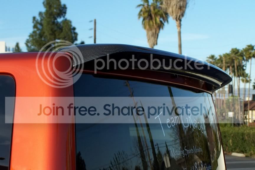

What I should've said is, that the mounting points or patterns with my CF spoiler is the same with my OEM spoiler.
Hot Lava came with the original OEM spoiler from the factory / dealer. (not whats on the pics.) They are a part of the RS 1.0 package, so there was no drill for me to make.
the CF spoiler that i have, mounts exact to how the OEM spoiler mounts to my bX. Two mounting points on the top part of the spoiler with 2 bolts (with caps to cover the bolts), then the two mounting points on the bottom part of the spoiler with "snap" connector (not sure what they are called at this time, sorry.) anyways they snap into my bX.
