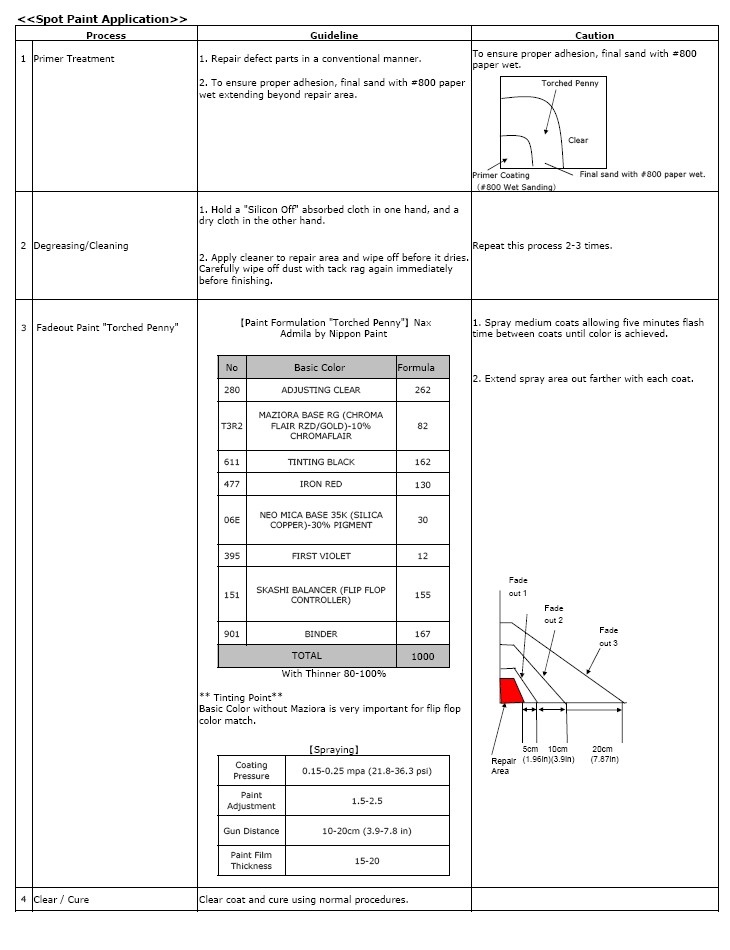

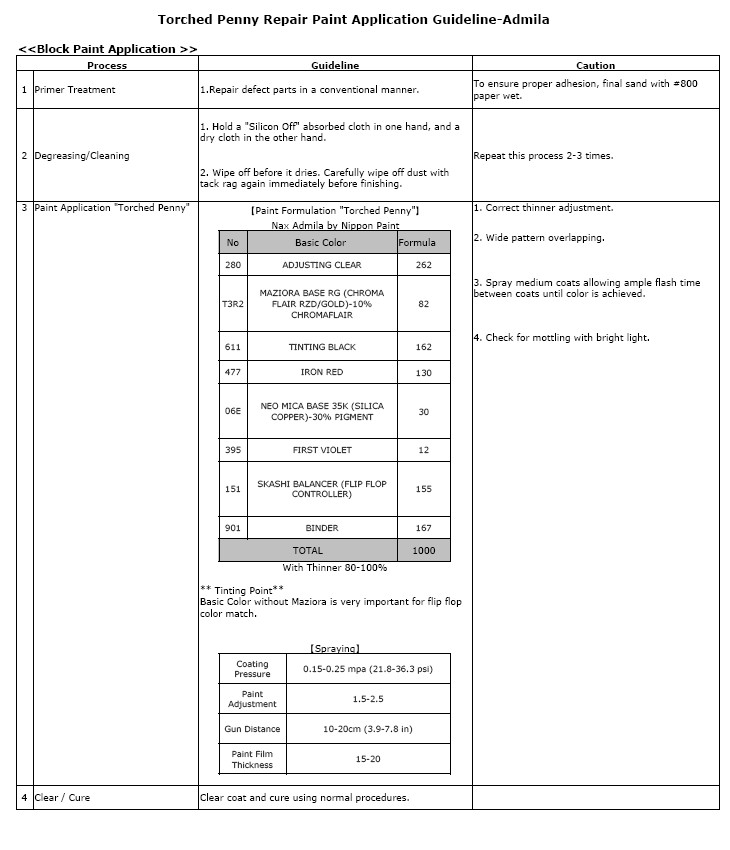

Default Torched Penny Paint Repair Information

Awesome info Darren.
maybe we could put a link to this thread in the xB color information sticky?

YAY I've seen do it yourself kits for polarized and pearlesant paint kits. Do they have on for TP.... I'd like to hit up the interior. The dealership wants 400 to do it I say F that.

its just a basecoat/clearcoat paint. go to your local paint store and buy a pint and do it yourself. $400 seems a bit high, what were you wanting done?

I thought it is a three stage paint. and if thats the case are there any tricks to doing it right. I'll be buying DIY areosol cans

nope, its only a 2 stage bc/cc. the color changing paints are actually easier to paint, dont ask me why, but they seem to spray on easier. with the mystic mustangs you can actually panel paint the color, instead of blending. no special techniques or anything for this color, just spray it as if if were any other color.
