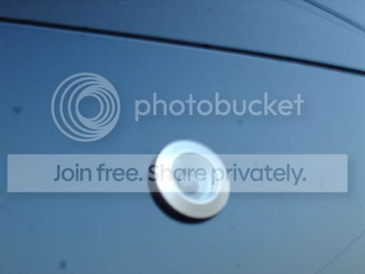

Old Jul 6, 2006 | 01:43 PM
Boxer_Rebellion's Avatar
Posts: 2,556
Here's what I ended up with...
