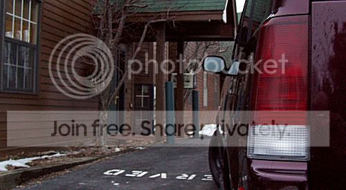

Just like I promised:
I'm letting the clear coat dry 24 hours plus it's raining so I can't put them on yet.
...the dot on the left one is from my dirty camera lens

Nice job both of you. I'm just not a fan of the Chevy Astro van look.
