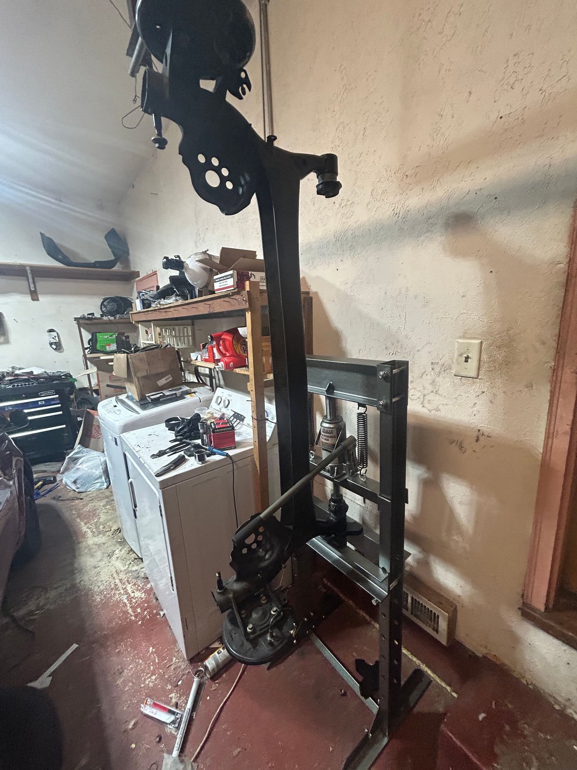

I know this is an older thread, but posting in case you haven't figured it out yet:
Professional mechanic of 8 years here. I generally shy away from definitively saying what's wrong without seeing the car, but I can almost guarantee you that your rear trailing arm bushings are the problem. I had a very, very similar issue on my '03 Echo (same frame and suspension setup as first gen XB). Darting around the road at highway speeds, wandering, rear end floating, riding rough, pulling in either direction seemingly at random, generally feeling like the rear wasn't connected to the front of the car, also felt wildly unsafe.
#2 in this diagram
Those bushings are the only "solid" point of contact between the axle and the frame, so if they're bad your rear wheels won't stay pointed straight; they'll move around freely, essentially allowing the car to be steered via the rear wheels, completely uncontrolled. As you can probably imagine, this will cause every symptom you described.
Mine were completely ruined at only 160k miles when I replaced them, California car so no rust. If you're on the originals at 200k+ I can almost guarantee it's your issue.
Unfortunately it's not exactly an easy or cheap job to replace them. I believe book time on them is 3.5 hours, and it requires special tools. Bushings are about $60 a piece (for genuine Toyota), plus the 3.5 hours of labor for a total of around $700 at $150/hr plus tax and shop fees.
Picture below of what's involved:
Have someone check them out asap, the car is not safe to drive when they're bad. I would also recommend finding a new shop than the two you've been bouncing between.
good luck
