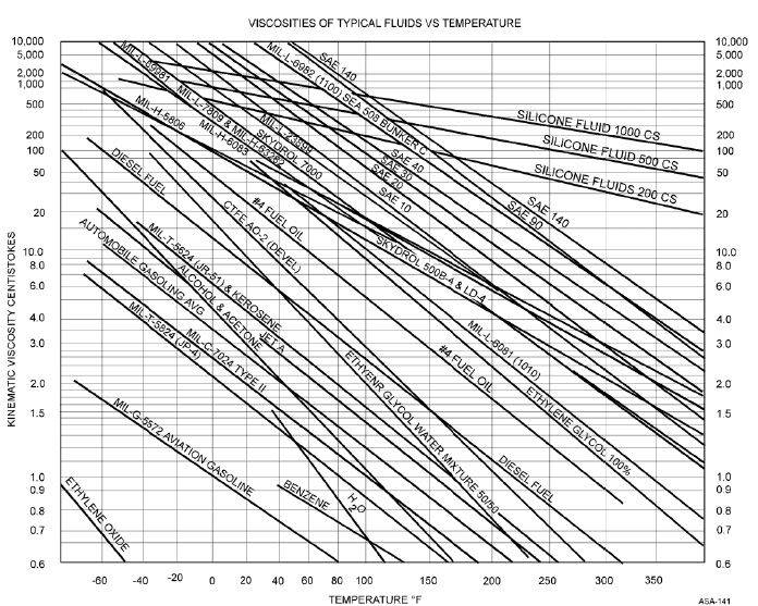

I switched oil in my triumph bonneville from 15-50 mobil 1 to 5-50 castrol syntec and the mpg went from 50-52 mpg. If they made a 0-50 at reasonable cost I would put that in. Pumping cold oil around does make a diffence on that bike and as it has carbs, the idle speed doesn't vary as much either.
I found changing the air filter out on the XB to be a really good idea. The OEM one seems to be really restrictive and despite O2 feedback, it still runs rich. The lad just drove 700 miles from CA averaging 27mpg. I swapped out the air filter and on the return trip he got 35mpg.
Interesting chart - might help stoke the oil debate
Rich

That chart hurts my brain lol Very interesting to say the least.
