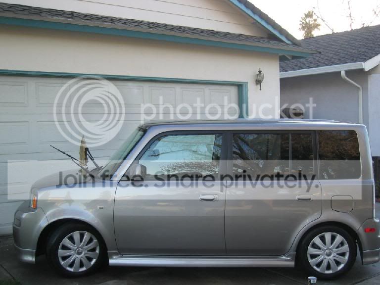

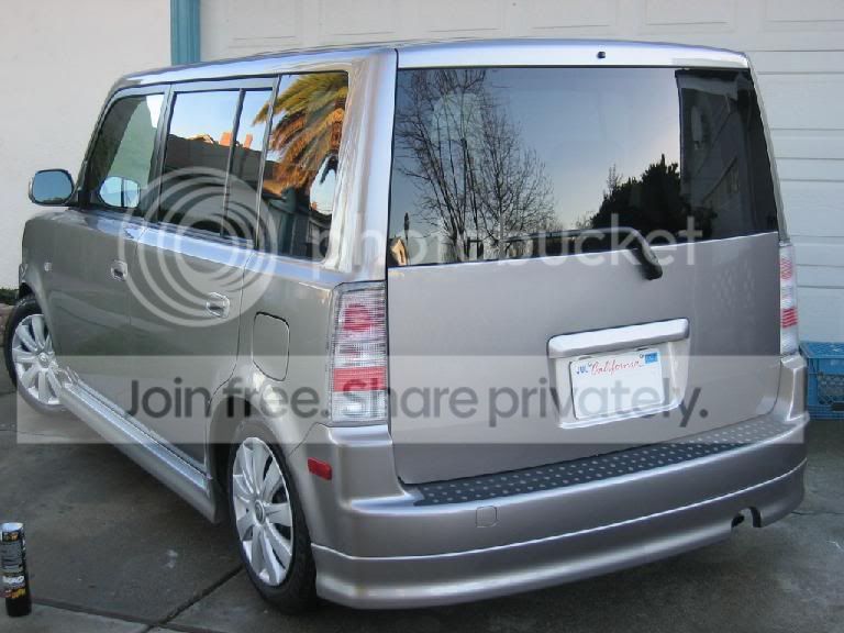

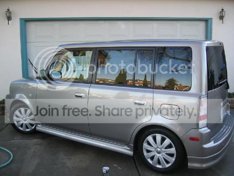

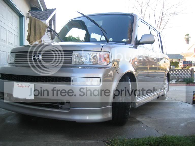

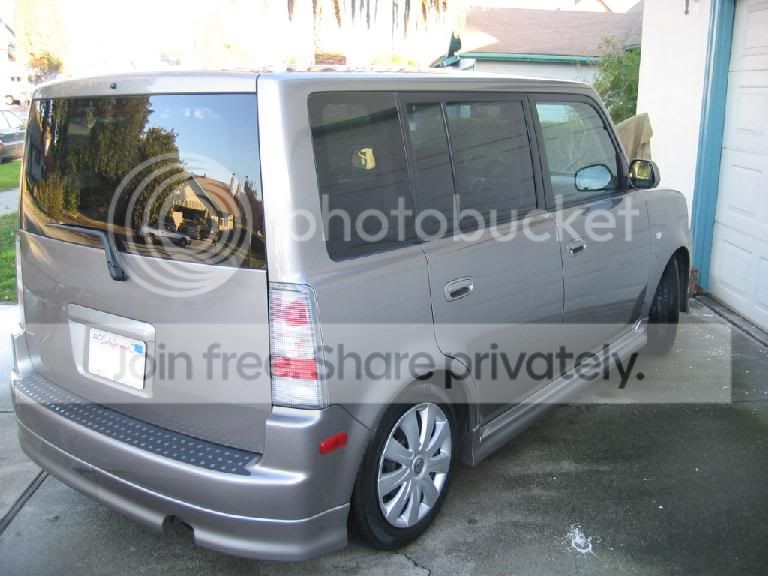

here ya go
*Note: pictures have been shrunk due to unknown reason... my appologies, if you want full image's IM me or PM me"-Thanks
[/img]
FYI>>> SPRINGS HAVE NOT BEEN SETTLED IN <<<FYI
More pictures will be posted after a week or two when springs have Fully settled in.
Enjoy
-Mark

Looks nice dude! Good job! So, even though they aint settled yet, how do they ride? Feel good?

Now that's a sweet drop. Those are 2.2 inches in the front and 2 inches in the back correct??????

The ride is Phenomenom... Best ride ever, for those who say the df210's are really bouncy n stiff, thats due to road conditions, define me your definition of smooth and bouncy ride... Tanabe Df210's are made with a special amount of spring rate ratios which are:
Spring Drops: Front: 2.2 Inch Rear: 2.1 Inch
Spring Rates: Front: 2.8 kg/mm Rear: 3.0 kg/mm
<img src=http://img8.photobucket.com/albums/v28/swtbabiboi4u/xangur/tanabe.jpg>
With the springs on my car right now, the ride is not bouncy, its a really smooth ride, it Hugs and hugs the road perfect. right now im just holding off on my Shocks due to the factory shocks are still new and good for another 16 months.
Tokico Blues/Whites are a good recomendation along with Cusco under frame brace along with a Tower brace any brand will due. ur own preferance. As for alignment its perfect no alignment required for Tanabe DF210 had them checkd out already. Camber position is perfect no kit required unless under heavy loads on a regular basis. PM or IM me for any questions on my suspensions.

my estimation my car will be be off the ground about 3.6-4" ride height. car drop estimate front and rear 2.5" drop all around.

Is the car level or does it have a nice little rake to the front?

it has a nice rake in the front. if you see it in person, you can tell there is a subtle dip. it looks real good in person
