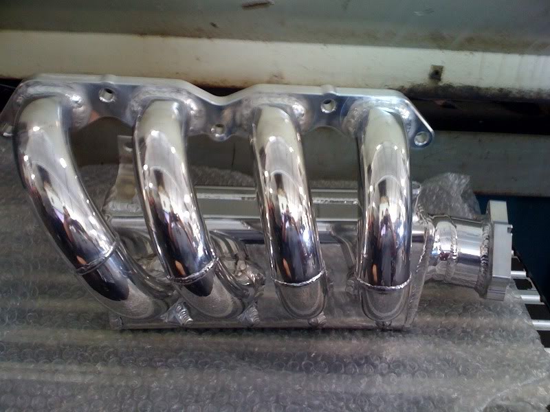

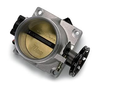

Here's some pics of the sheet metal intake and big bore t.B.

Adapter for T.B.

Well there it is, you want to go all out? thats the set up I'm using on this new set up along with doing direct port nitrous. I've got to drill 4 holes in the runners and weld 4 bungs for my NX Pirana valves.

sick set up....

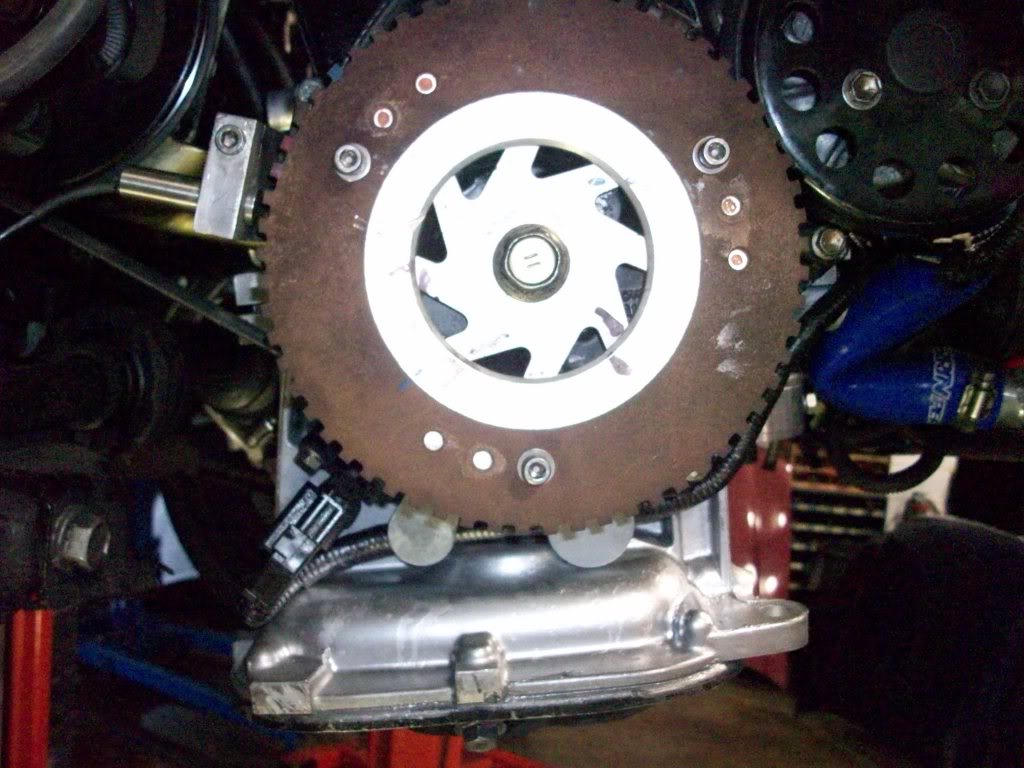

Here is the crank trigger that is used for my timming

^is that blue hose kinked? Interesting build! Any more pics of the engine, and xB itsself? Also did you have to upgrade your axels, motor mounts and/or subframe?

That blue hose isn't even on the car. The pic was taken when I had the head off and it loose from the motor mounts and was doing work. Yes axels are made by Gator axel.
