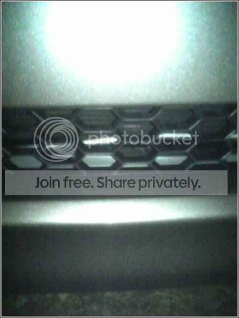

Alright here is a picture of my xb... The circle on the picture is the area to focus on as I tell you what happened to my xb.
I was driving down to a friends house when an owl flew out into the road and my box hit it as it passed over it. The red circle indicates where the impact happened. There doesn't appear to be any external damage. The damage is BEHIND the lower grill (driver side)
Here is a close up of the bent up area which is behind the grill
and here is one more photo of the damage
My question is this ... what is the silver color part that sits right behind the lower black grill (the piece that is bent up in the right side of the photo behind the black grill)? Is it the radiator support? Is it an expensive part to replace/repair?

It is hard to tell from the pictures, but I am pretty sure it is the aluminum tubing which goes to the air conditioning condenser. If it has not ruptured and leaked out all of the refrigerant, it is fine. It does not look severely bent or kinked. Try out your AC and if it cools OK, you probably did not hurt anything.

i think SP is right, i noticed this on my brand new, Non-Owl Impacted XB and thought it looked kind of odd and out of place, so i think you're fine

I will add my confirmation.My 06 has the same tubing.I plan on painting it as I think it stands out like a sore thumb

Yes it is normal and I have a 2004. If the impact was significant, the damage would have been worse on the lower grille inserts or front air spoiler/front lip.
