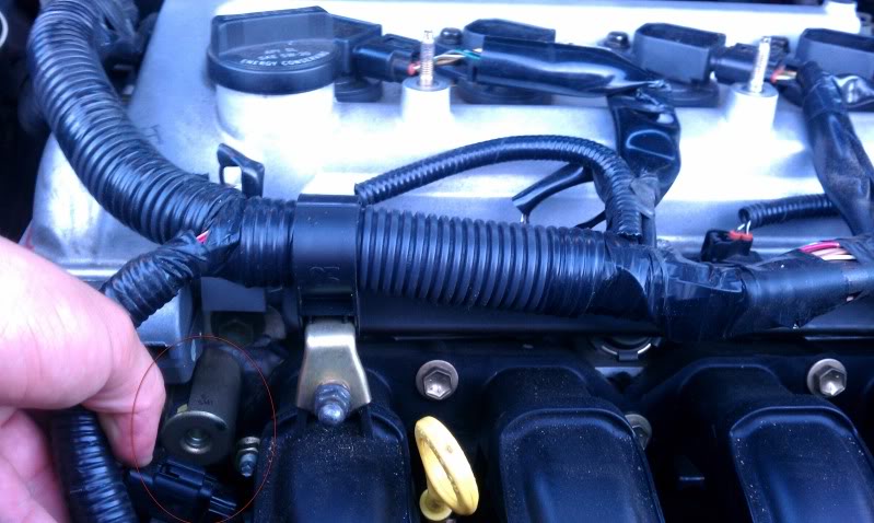

So in the process of changing my alternator and power steering belts, I accidentally broke a sensor at the plug and I'm now seeing the CEL, VSC and Trac Off lights on.
Can someone tell me what sensor this is so I can replace it? You can see it on the bottom left corner of this pic:

i think its the vvt-i sensor

Not a sensor. It's a VVT Oil Control Valve.

Yep, figured it out with tc-guy's response. Thanks to you both.

i did the same thing at the end of last year during my belt replacement as well...got the part for $75 dollars and was really easy to replace.
