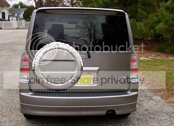

How about this?

^ looks good. But there is no way that it can be attached to the cargo door. The hinges, metal thickness, strenght of the area where the door shocks are mounted etc,- everythyng is against it. I cant think of the car where the spare is mounted on the swing down door.
Good fabricator, a tow hitch shop perhaps should be able to design a frame that goes under the bumper to the body subframe. Thats where the strenght is. The tow hook hole can be utilized too if not as main mounting, but at least as an additional mounting point.
I think it is totally doable and worth the effort.

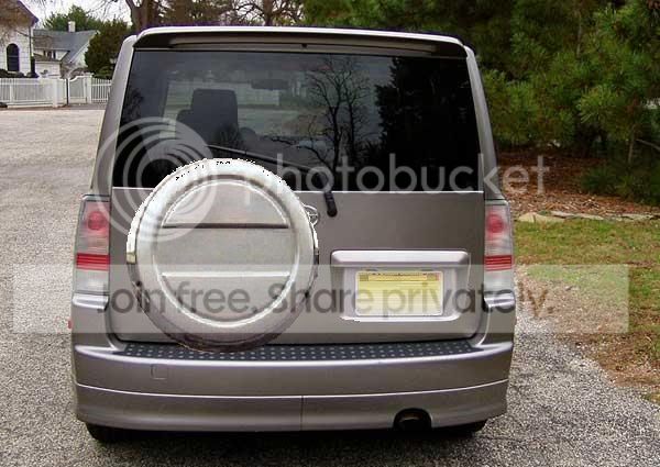

Relocated the door handle . Still looks kinda funky.
