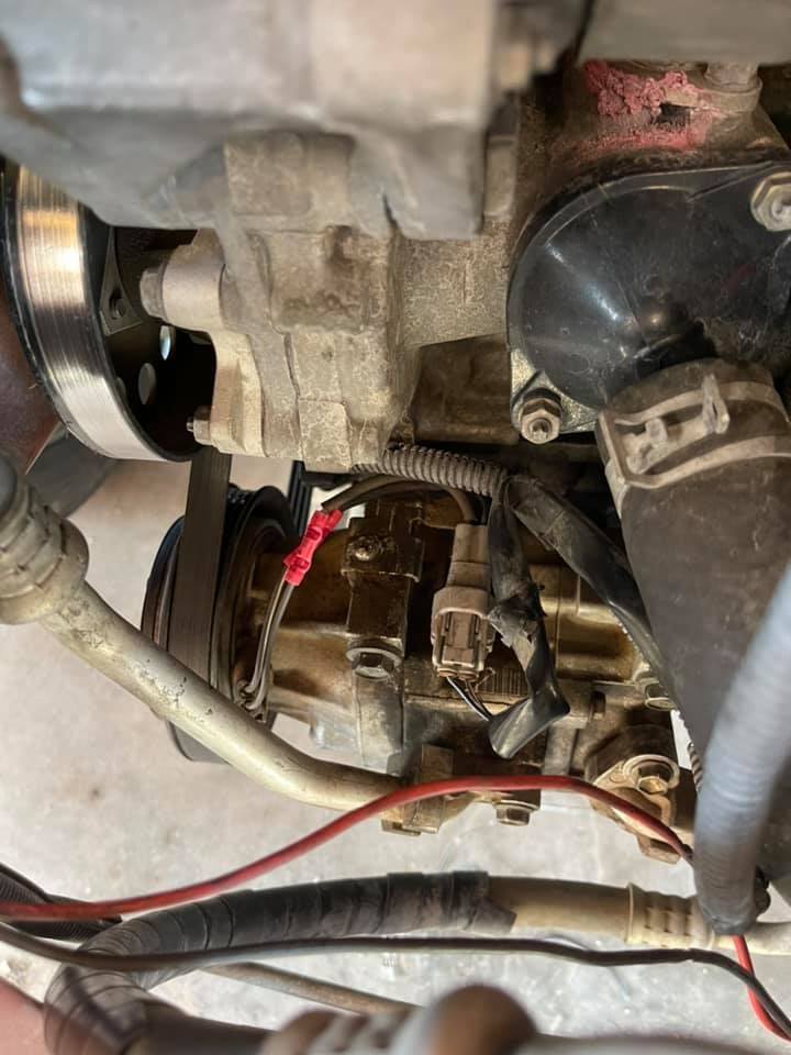

Cool Here it is

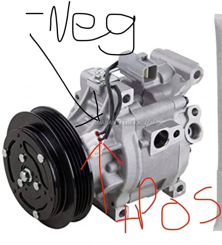

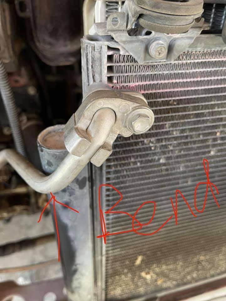

I believe anything 2000-05 will work, my Echo compressor and lines are from a 2003 Echo. The two lines you need are the Toyota Echo Discharge Line and the Suction Line. The liquid line is all metal and does not need to be replaced, the OG Scion xB liquid line works fine. So you could in theory have a 2003 Toyota echo suction/condenser line, a 2004 Toyota echo compressor, and a 2005 Toyota echo discharge line. In any combination. But those three items HAVE TO BE from a Toyota Echo 2000-2005. The belt is a K040465 or a K040488, both will work fine. As you can see in the picture with the red arrow and the "BEND" caption, this was the only line I had to modify, all I had to do, was just take a little bit of bend out of it, until it fit, so it would wrap around the condenser. I butt connected the wires to the stock factory wiring, picture for proper wiring. My system has been running just fine since I did this upgrade in 2021. I've only recharged ONCE, not because of bad work, I had an AC service port valve go bad. Replaced the valve, recharged freon, system working beautifully again, no more leaks.

I just wanted to drop a thank you into this thread. I’m wrapping up swapping my compressor out now and the pictures and parts description helped a ton. I tried to be sneaky and wire in only the positive, but that didn’t work, so I took it all back out and did the negative also. Hopefully that works. One note, on my 2006 (which I think has the larger condenser) it was not a minor bend to get the Echo line to fit. It was some pretty major bends and I’m scared I weakened the line, but whatever, summers here aren’t all that hot anyway. 😉 Thanks again Scion folks!
