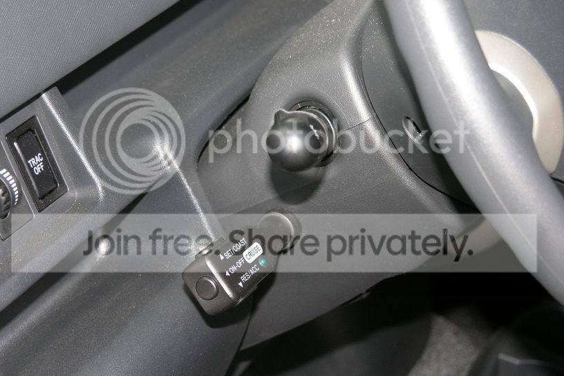

I didn't put the control stalk where the instructions recommended. The good part is that I won't hit my knees on it. The bad part is that I can't see it while the steering wheel is straight.

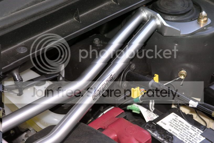

Here is the control box nestled under the strut tie bar. I had to use only one screw on top of the control box to attach to the bracket provided with the kit.

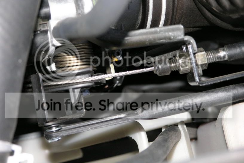

Here's another view of the control box:
Here's a view of the additional bracket you have to add to the throttle body:

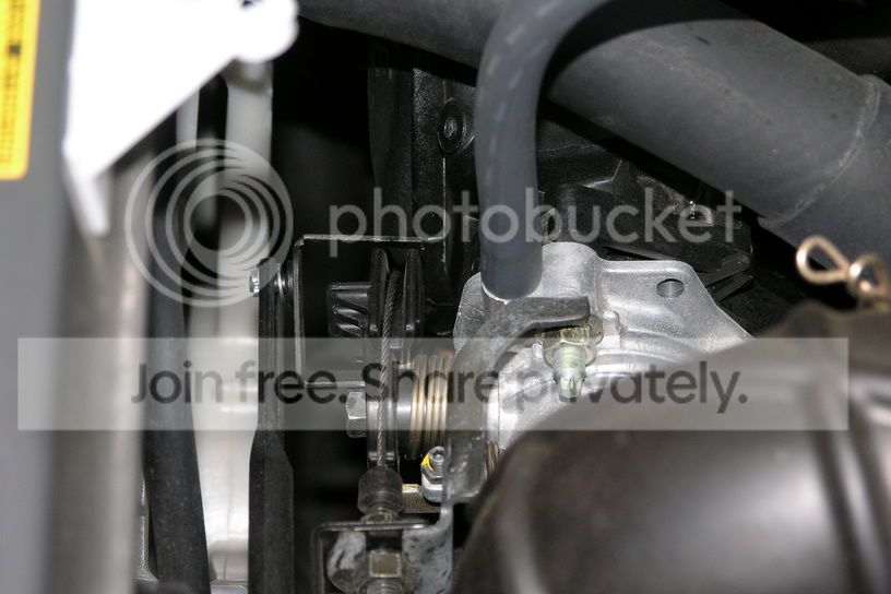

Here's a closeup of the same bracket:
Good luck!

Nice pictures, gslipply. You did a great job !! I want cruise also. My question is, why couldn't you have mounted the stalk BEHIND the turn signal lever?? From the pics, it looks like it might work ??

its hard to see it now if you put behind the turn signal you wont be able to see it all. I would have been nice if they made it to fit on the steering wheel itself.

Thanks. The tough part is the under-dash work. I found the access very difficult for not a lot of wires to hook up (12 V power, clutch, brake, speed sensor, and control stalk). I'm still healing from it after a few weeks.
jethro b is right; there really isn't a good place for the stalk. I even considered making it some sort of "box" mount, but that would have looked too JC Whitney or something.
