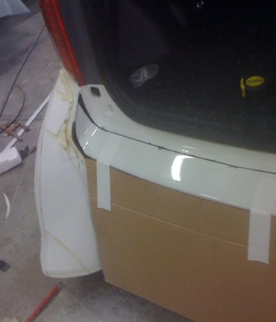

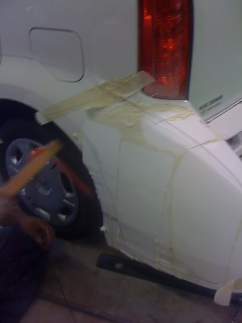

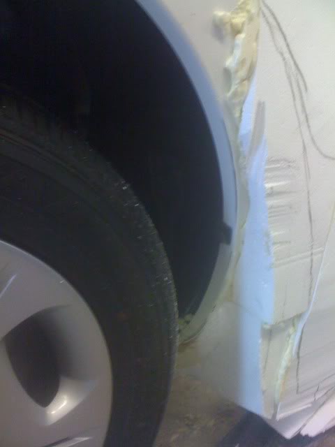

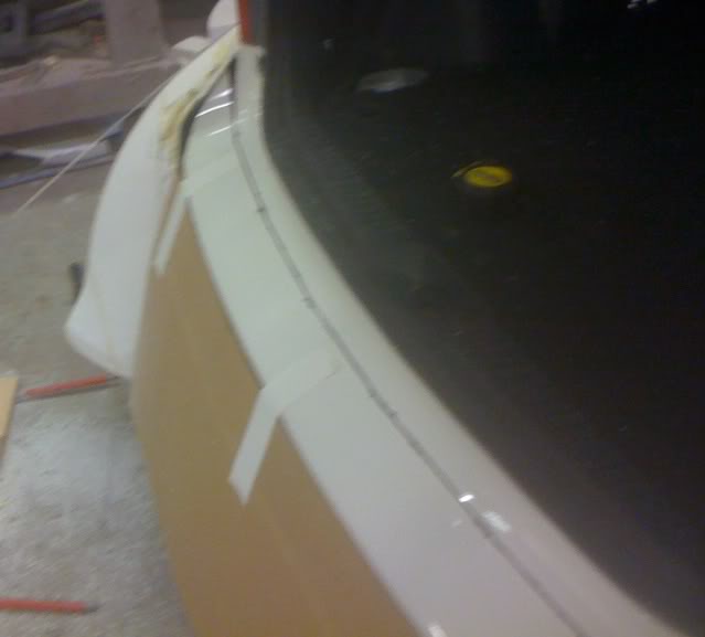

Steve wanted me to share these photos with you all.
We are showing the beginning to the end...that the initial pictures are where we started and continued to hone down the foam to the right shape and size. The final product results in a bumper that is 7.5 inches longer than stock at its bottom center of the outer bumpers. The middle section is just merely three inches past stock. The initial pictures were 18 inches. The final bumper will be revealed late next week as the fiberglassed part has significant detail not yet on these foam shapings.

This is a work in progress, the two sides are not 100% equal, the final bumper will combine the best of each side and have more detail. Also keep in mind we are tweaking the side skirts and bringing them up a little so they are not as low and will flow with the rear bumper.

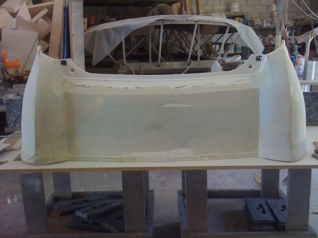

rear bumper off the car with detailed center section
