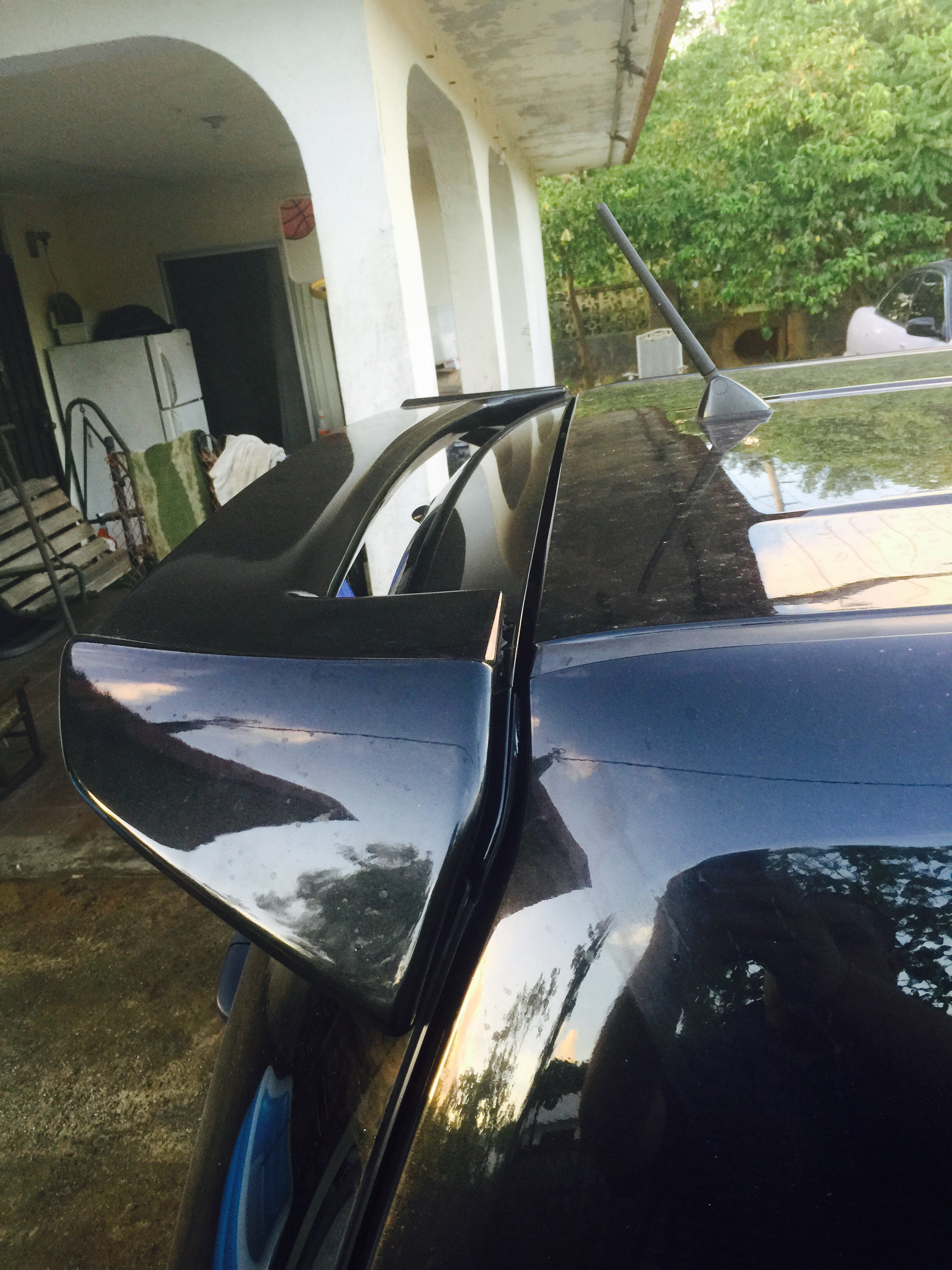

I got the same one on eBay and installed it today, took about 2 hours with a helping hand from the wife to hold it in place. I recommend this item, for the fraction of the price vs OEM.

Old Jun 13, 2015 | 11:40 AM
ilocano671xb2's Avatar
Joined: Jan 2015
Posts: 8
Here it is
