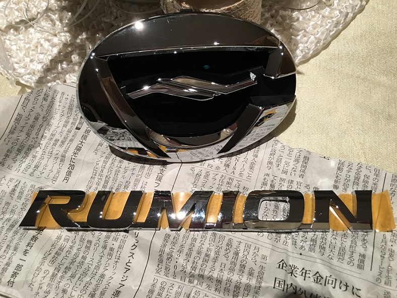

I'm back after a while with an update and pictures on how it came out!
So, I ran into a problem. When I ordered the emblem, they sent me the emblem for the 2015 Rumion or latest model. Believe it or not but the 1st gen Rumion emblem is what fits the 2nd gen xB.
Who would have guessed that.
Well I spoke to the seller in Japan and he sent me another one for free BUT it was the same one
but slightly darker. It took 2 weeks to arrive.
I said whatever, I'll make it work somehow.....
So after waiting and trying to figure out how it might work out with cutting the hole, I came to a different solution than what was previously posted above.
Now I didn't know if I could make it fit and if I made a huge hole and it didn't work, I'd be totally screwed. Instead of cutting the huge hole into the front end, I used the dremel to shave off the whole back of the Rumiom emblem. It came out clean. only the hooks where left. The bottom 2 hooks are the same but there is only 1 in the middle, where as the Scion emblem has 2 identical ones top and bottom.
I took the dremel and just made a hole, didn't really care if it was perfect, just needed it to fit the top hook. I attached a picture of what it looks like. Should I have messed up completely, I can put the original Scion emblem back on and no one would know there's a hole behind it. Thankfully that's not the case.
