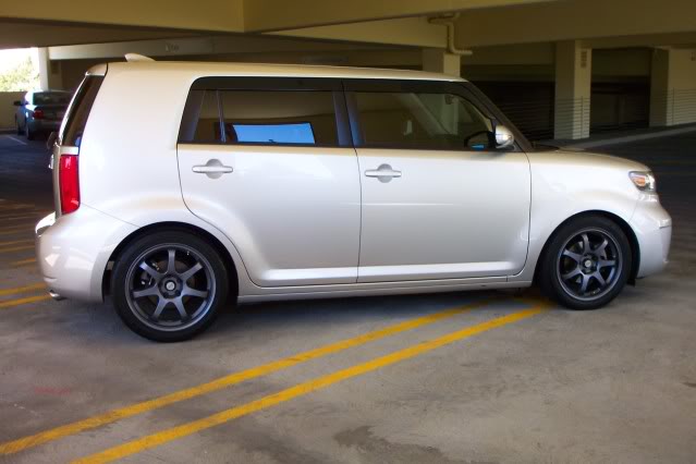

I went with an old school panel truck look (larger rear wheels & tires than front), without the Mr. Potato-head plug-in spoiler look. I think it looks great with the Shark-fin antennae, and I never really liked the look of the fin antennae with the Mr. Potato-head TRD rear spoiler.
