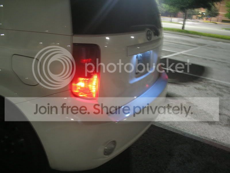

does anyone know how to replace them?
tried but was afraid to break anything..

You have to remove that big back panel on the inside of the hatch. It's hot difficult to do.
What I did is this: decently wide flathead screwdriver, wrapped it in electrical tape, and pryed. It uses the same type of clips (if that's what you want to call them) that the door panels use. Then after you're done, pull the clips that didn't come off with the panel, put them back on panel, and clip back on. It's easy!

hey thanks bro.. just finished installing the led ones.. yes I was little nervous pulling the black panel at first but after the first pop it was easy.. thanks man!

yeah I got the white led and the are not ridiculously bright.. they might look brighter on your box since it's white though..

2 lights with six leds in each
