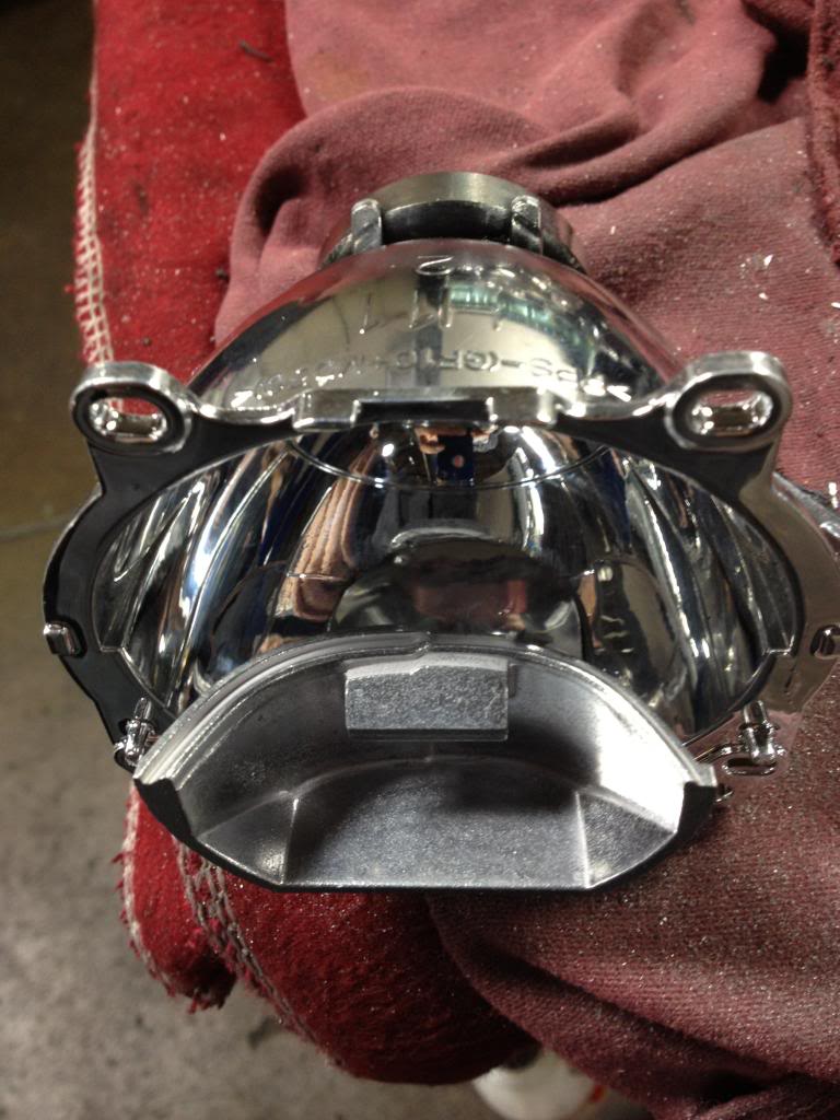

So you just did a lense swap? Why not do a complete projector swap?
If those are fhe stocks with just a clear lense, its actually better than I expected...trs does have a clear lense now for japanese vehicles

I use the stock housing and mod the TSX light shield on it. Name:  photo3_zps0497a94a.jpg

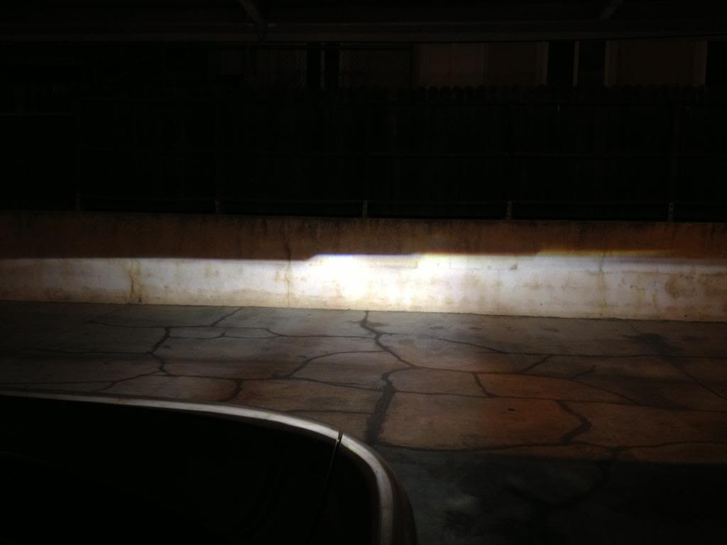

Hows the color at the cut off? This has got me thinking lol..I rather do it this way than using the minis or chop up my housings

Have that blue-ish touch at the cut off Name:  photo_zpsbe0b59b6.jpg
