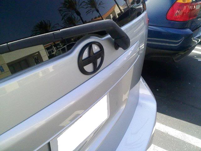

I think the black on red would look awesome. I did both the front and rear scion badges but removed the xB badge about a month after i got the car. looks cleaner in my opinion but to each his own. Had the front done for a while but never did the back. I used Krylon Fusion for plastics in a satin finish. Use a scotchbrite pad and scuff the surface so the paint will stick better. I did about 8 very light coats until the whole surface had an even finish. You night not be able to salvage the adhesive off the back , so get a small roll of 3m outdoor mounting tape. its just as thin as stock but way stickier. I thought about trying to color match the lettering tot eh car but unless you paint it by hand i don't think it would be possible.
sorry for the bad cell phone pic.

True value or Ace hardware i think. it was like 4 bucks for a roll. oh andby the way, to remove it i just used a heat gun on a low setting and used it about 6 inches from the badge. after a few minutes i used a heavy fishing line and used a sawing motion behind the badge to loosen the adhesive. there are two pins on there but you can work around them..
heres one more pic
