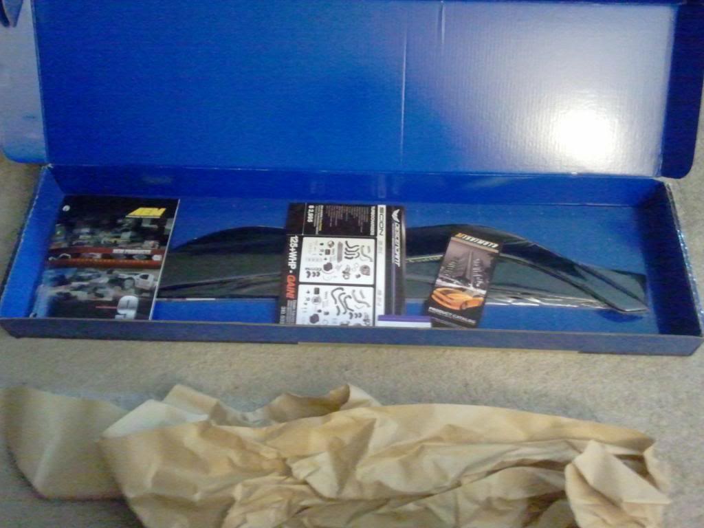

OPEN THE BOX.
  • Using a box cutter or other cutting utensil cut around the visors. BE CAREFUL not to scratch the visors.
  • When removing the plastic that holds the visors in place.
  • Take the instructions and throw them away. You have this DIY.

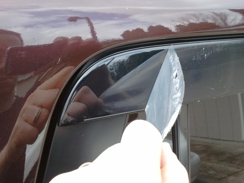

  • Peel back 2” of tape liner from each end of the visor.
  • Make sure that the tape liner ends are accessible.
  • Align the front visor on the outside of the door frame.
  • Attach to the door frame.
  • Once you are happy with the alignment remove the remaining tape liner by pulling SLOWLY on the free ends working your way towards the center of the visor.
  • Apply pressure along the flange to ensure proper adhesion. FIRM PRESSURE!!
  • REPEAT FOR OTHER 3 WINDOWS.

  • Carefully start pulling the film off of the visors one at a time.
  • Check all the edges making sure you get it all.

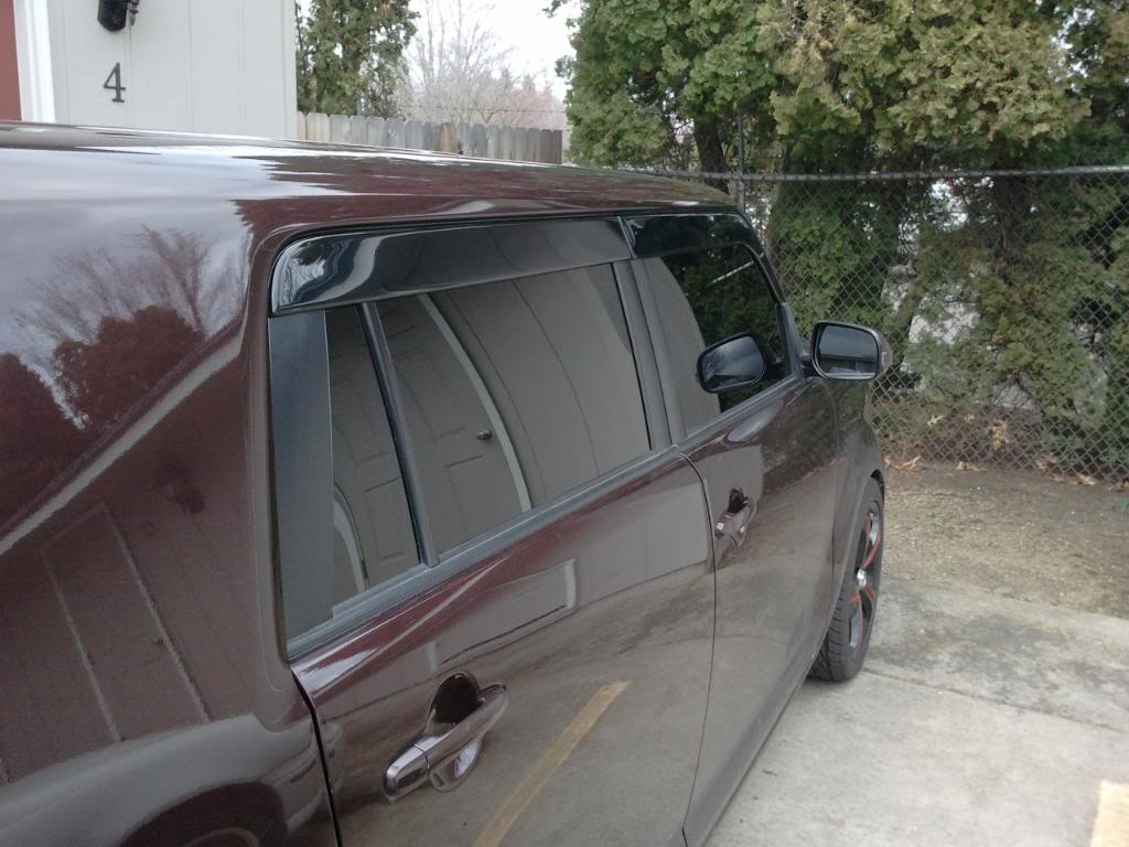

That is it. Step back and see what a difference these visors make to the overall look of your vehicle.
Windows Up
windows cracked:
My windows are tinted at 5%.
I hope you find this DIY helpful in you decision making process and with the install.
