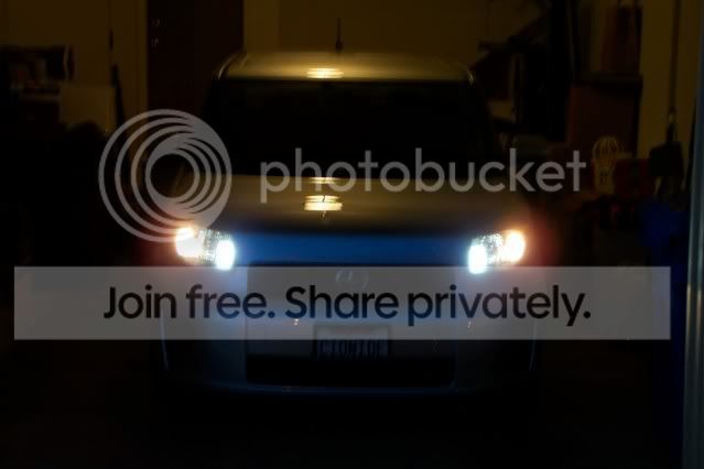

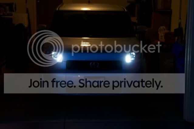

Replaced my amber incandescent front turn signals with V-LEDS dual color front LED turn signal bulbs. "HID" white running lights (actually more toward the blue color of 5000k-6000k HIDs) that blink amber when the turn signals are on. The link has a video showing them in operation:
http://www.v-leds.com/Exterior-LED/T...-p5851397.html
The lower power draw of the LEDs will cause the turn signal to hyper-flash really fast, so you need to get the replacement flasher also:
http://www.v-leds.com/BlinkerWarning...-p4481146.html
You just have to snap off two thin little pieces of plastic on the housing for the new flasher to plug right in.
BTW, with the new flasher none of the running lights will blink anymore when you use the lock/unlock buttons on the key remote, but the audible beeps can still be heard.
Sorry for the bad pics, my camera sucks and has a dead battery that won't hold a charge anymore.
Can't wait to put in HID headlights, so they don't look yellow.

Wow! they look really good! Just something else to put on the to buy list...

That looks awesome! Did you remove the side marker bulb?

No, I left it in, you don't notice it from the front.
