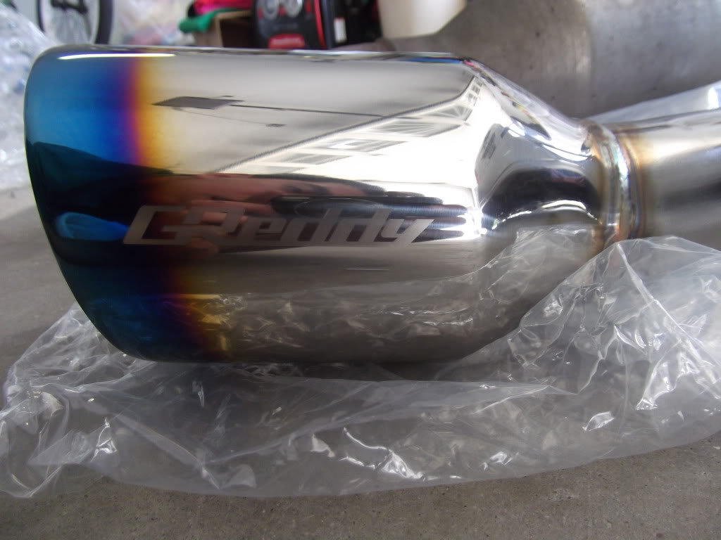

ok so ive noticed no one has done either pics or vids on this exhaust so here it is
this is a install and pics write up. so after looking around and doing some research i found out the GReddy has discontinued this product (pn.10117954) but managed to get my hands on one through a ebay dealer located about a hour from me in LA.
ok so here it is i received the exhaust monday

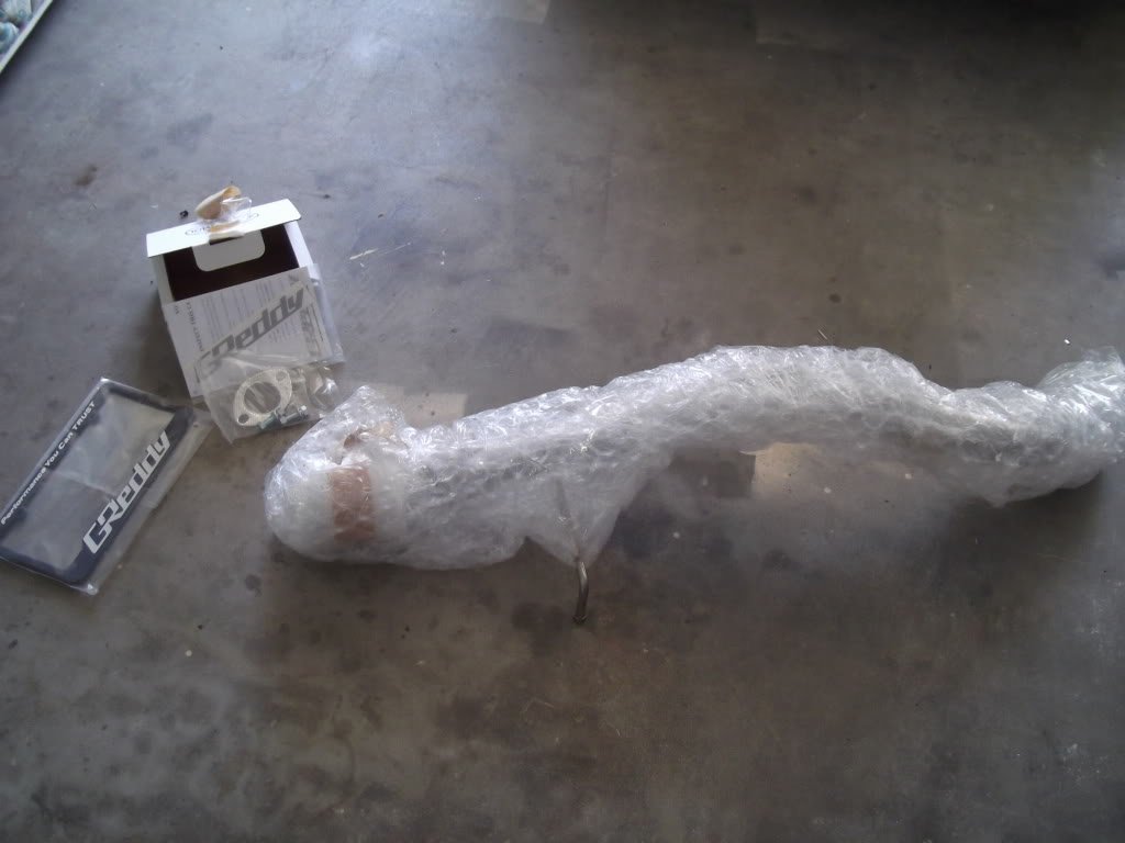

heres what comes in the box (axle back, hardware, gasket, license plate frame, warranty card, and a sticker)

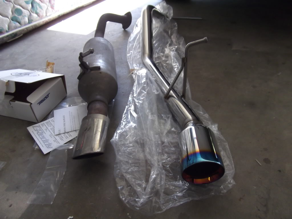

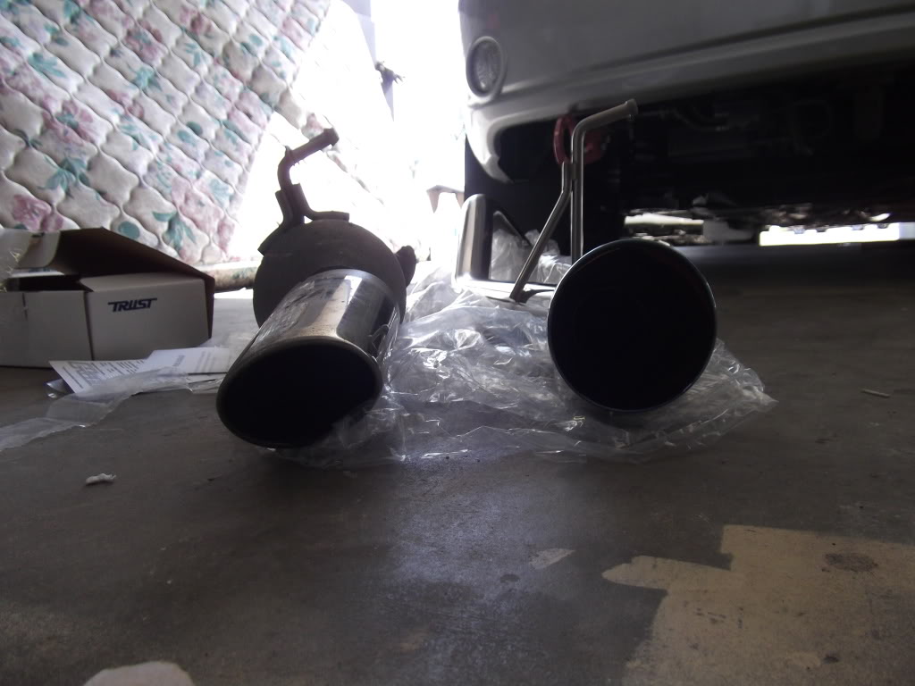

here is the comparison of the stock vs the GReddy

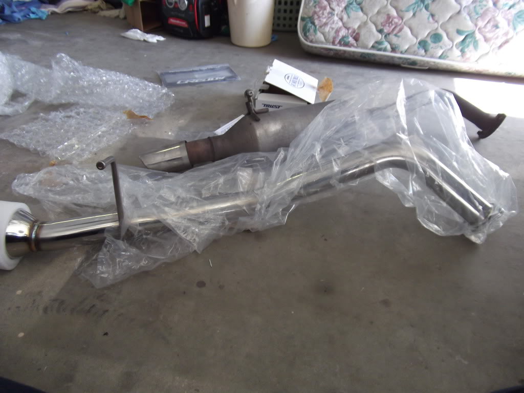

ok so the now the install of the new one. here a lil trick i learned from doing all my other exhaust systems. place the plastic the piping comes in back over it like so; i also left the tip wrapping on to protect it from damage
now slide the piping back over the axle and install the hanger post first should just slide right in no tools needed.

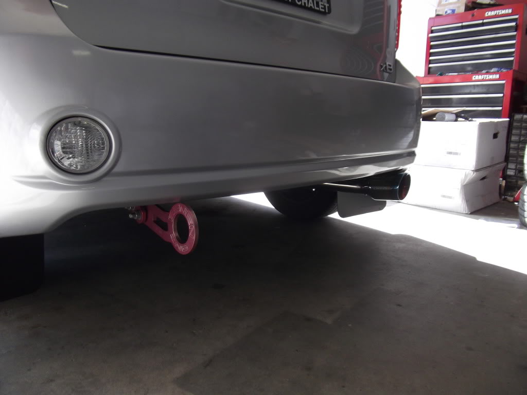

place the supplied gasket between the two flanges and bolt together using the supplied hardware, passing the bolt from the mid-pipe side through then place the lock washer and finally the nut. hand tighten then line everything together and tighten down. if u feel like the bolts might jiggle free for some reason place a lil loctite on the threads before placing them in. after tightening everything down and checking twice u have a finished product like so...

ok so here are a couple new pics and the new video will be added as soon as its done uploading. pics look a lil weird but it was like 6 but in person no fading or discoloration what so ever
