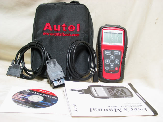

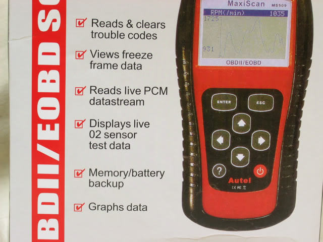

As Fred pointed out, the best defense is to get yourself an OBDII code scanner (or at least beeline to the nearest Autozone and get the codes read). I purchased mine for about $60 via Ebay -- very satisfied !
