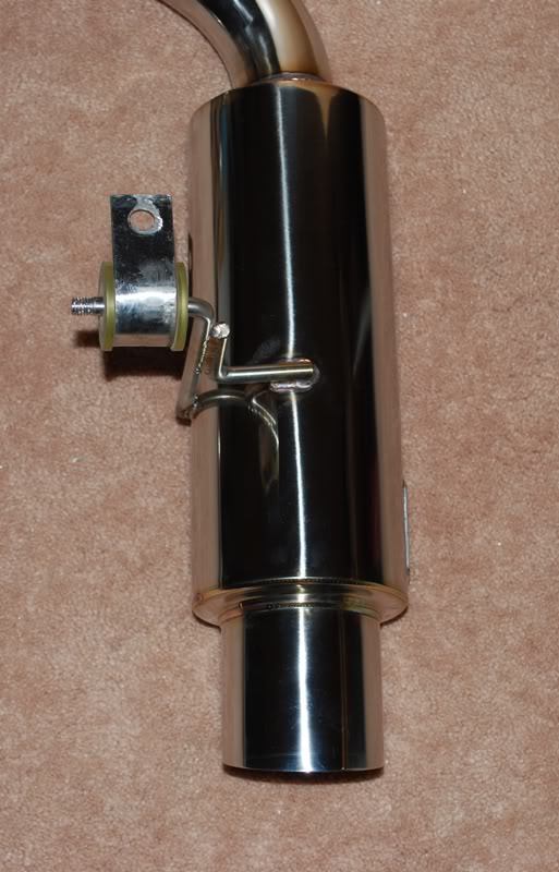

I decided to go ahead and install the Tsudo 2008-10 Scion xB with Five Axis Lip Kit Fireball Axleback Catback Dual Exhaust System tonight that I purchased from speed-element.com. It's supposedly a simple bolt-on installation. So, I figured 2 hours max. Well, I didn't get very far. It came with no instructions whatsoever. There are PDF instructions on their web site, but the photos in those instructions do not match the product they sent me.
For example, here's the instructions for installing the rubber bushings on the hangers that support the mufflers:
5.2. Verify that the metal tabs on the rubber muffler mounts are oriented to the outside of the car. If they are not, remove the nut and flip the rubber bushings. The picture shown has the bushings in the incorrect orientation.
Why include a photo in the installation instructions that show how NOT to install the product.
But, that's nothing compared to what comes next. Here's the photo from the instructions:
And now here's two photos showing the two possible ways of installing the bushings on the hangers of the mufflers that were sent to me:
Notice anything? It sure looks like someone welded the hangers on this exhaust in the wrong orientation. The hangers on the product they sent me are rotated 90 degrees relative to the photo in the instruction sheet. So, it is physically impossible to install them (incorrectly) as shown in the instruction sheet photo, or correctly as described in the instruction text. How could something this obvious escape their factory "quality control"?
So, did they send me a defective product, or are their instructions out of date. I could probably spend a couple hours under the rear of my car tonight, removing my stock exhaust and trying to see if there is any possible way to mount the product they sent me to my car. But, it's 10:30 at night and I don't want to spend 2 hours working on something that may leave my car in an undrivable state.
