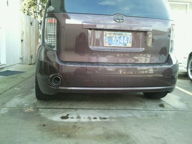

here's what I did.... I don't think it adds ANY power, but DAUMN it looks SICK!!!!
BTW.. NO MUFFLER!!!!! all straight pipe.. sounds AH MAY ZING!!!!
Looks really cool Andrew! I hope heat won't be an issue, doesn't look like much clearance from the rear fascia.

BTW A-Snell, that exhaust exit looks sweet!!! I may steal that idea if I can figure out a suitable reverse light re-location scheme.

Trevor- my last set up sat even closer to the bumper.. for 2 years... no problems. on this one there is around 1/4 - 3/8" on all sides. the hole is approx. 4" and the tip is only 3 1/2". I really like the NO MUFFLER sound.. My last set up was straight pipe out the rear. I passed DEQ with flying colors. So, running with no muffler should be ok.. I say should be cause I don't want anyone holding me to that claim.

Super cool dude ! Looks great and I'm sure sounds same !
