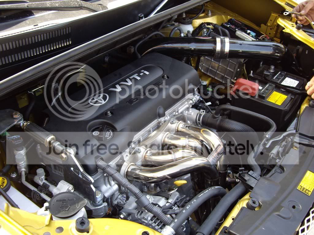

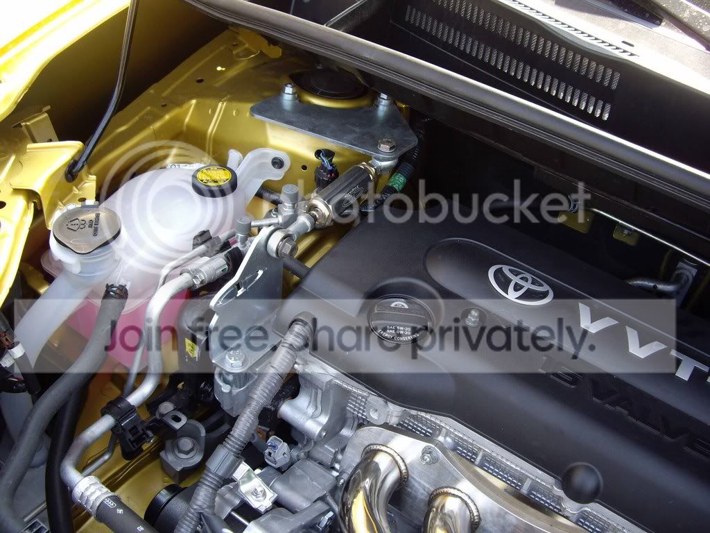

well i do have an ingalls etd installed and you'll be surprised how quiet it is. most of my passengers didn't notice i have a etd until i tell them but they'll ask me what i do to my car before i told them. they notice how my car accelerate and brake the transition feel very smooth even while i change gears ( 5spd ) there's is a slight increase in the engine noise department but there's no vibrations
Old Sep 18, 2008 | 10:26 PM
DAILYXB-TYPE-R's Avatar
Posts: 1,010
here's some pics

the first pic is what me and a friend custom made it while the pic below is the FIG. i'm planning on selling the FIG set ( upper and lower grill ) later

WHERE DID YOU GET THAT TORQUE MOUNT KIT?
Old Sep 27, 2008 | 02:20 AM
Posts: 1,010
ebay

NoLimitz reps Weapon-R, and they have a nice engine damper.
http://www.nolimitzind.com/dampxb08.html
https://www.scionlife.com/forums/viewtopic.php?t=212910
Old Sep 27, 2008 | 04:34 AM
lefteye516's Avatar
Posts: 35
with the damper installed...is there enough tread for a strut brace?
