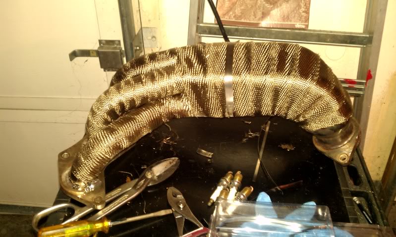

Well, here it is!
I decided to go ahead and do it, and if anything negative comes of it, I will just remove the wrap. So far, the under hood temp's seem to be MUCH lower.

The wrap looks great! Even if the header only last a few years wrapped, you can just replace it with another cheap ebay header.

Originally Posted by Roller_Toaster
Well, here it is!
Nice job !

That looks like 2" wrap on the single pipes, so I'm thinking that at least with these cars -- controlling the overlap isn't too critical,

I used two of the 25' titanium exhaust wrap sections. I also bought the weird locking metal straps...but...they didn't work, so I used radiator hose clamps that cost $0.25 each. Those locking straps were nearly $10.00 for 4...

FWIW -- I used 7 of the longer DEI locking straps ("S"-pipe and lower header) and they worked fine. Just ordered a pack of the shorter ones, but the design appears the same. I had to use pliers and a screwdriver to tighten them, but that's in the instructions.

hrmm...I tried using pliers to get them to tighten, but they just didn't seem to like me. I'm sure they work fine, I just couldn't get my butterfingers to make them stay tight!
