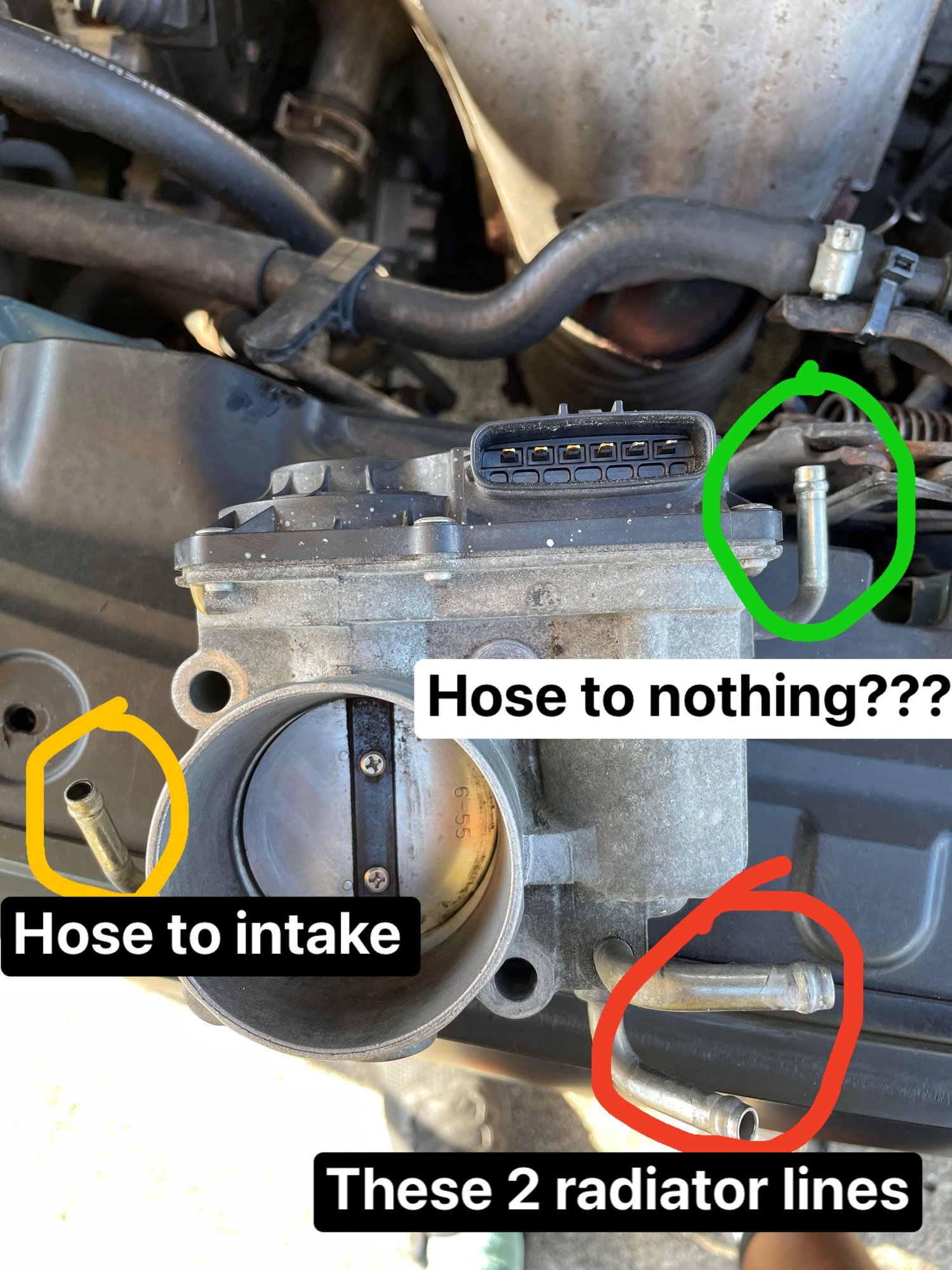

I have an 08 xB (2nd Gen??? I’m trying to get with the lingo) and the fourth hose on the throttle is not connected to anything on the other end.
Where does it go to?

In this case a picture is probably worth a thousand words as, "the fourth hose," isn't real descriptive. Help us to help you...

You are correct there. I have a photo of the the throttle body. I will certainly take one of the hose if that helps.

That should help a ton and I'm guessing some of the Gen2 guys will chime in shortly...
Or this might help:
Or this...

Or this might help: xB Throttle Body
Or this...
YES!!!! This is what I needed. I was able to feel for the nipple and connect that hose. I think I may still need to replace the hose because it’s a little dry at the ends.
thank y’all
