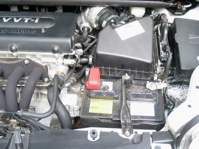

As of about two and a half months ago, it has about ten coats on it including the primer. Its appearance didn't change during that period until I wrapped the lower portion of the header, causing the pipe temp to increase, but after about a week, it restabilized. This photo I took yesterday shows the current appearance.
Like any paint, if you hit it with or against something hard, than you can expect a chip, but it doesn't by itself. If the installation and curing instructions on the can aren't followed, then flaking is a real possibility.
