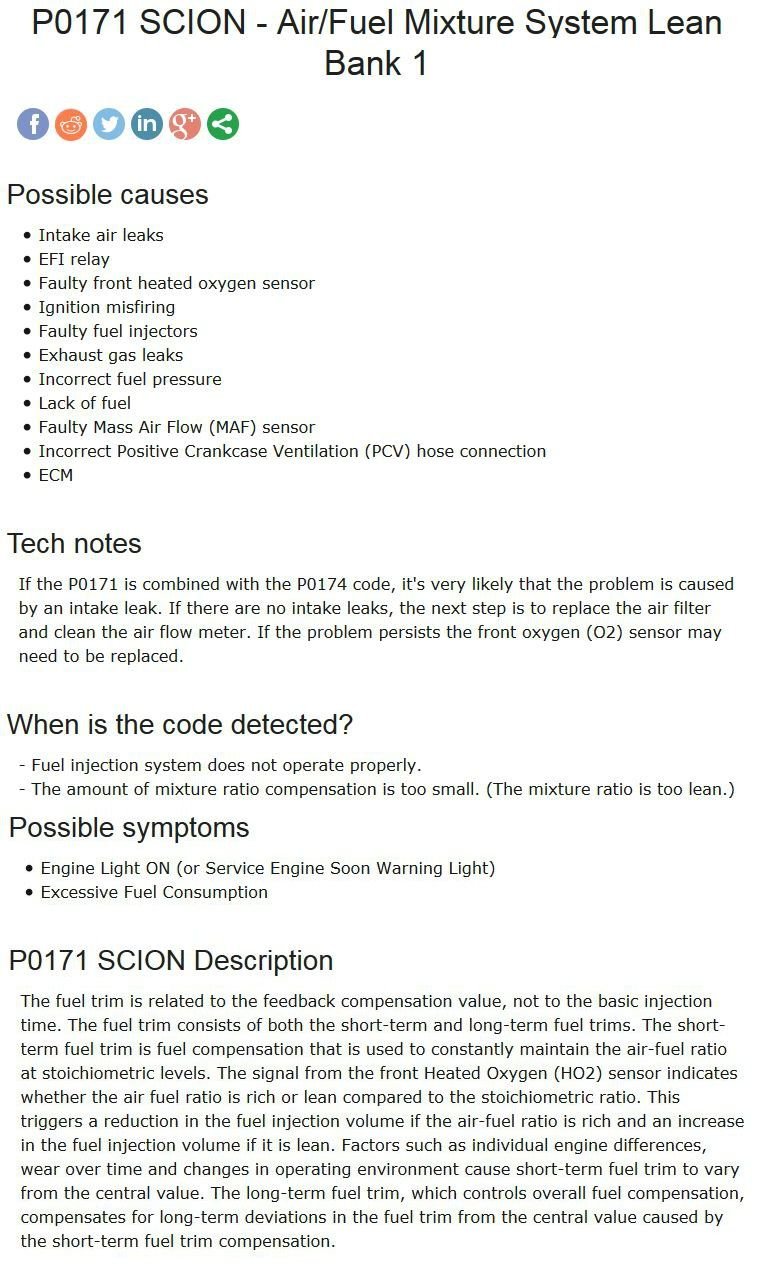

Hi all,
I have a Check Engine Light and VSC Off Light on the Dash
Getting error codes:
P0171 Power train system too lean bank one and
P0607 Power train control module performance
The car is sometimes hard to start after long idles with the A/C on.
Any ideas?

If you have over 100k on your car? Replace the No. 2 O2 sensor downstream from the Cat. Mine went bad a had the same P0171 code. I think Bank one is the O2 sensor after the Cat.
Run a few tanks of Top Tier gas. That will help rule out the a clogged injector.
