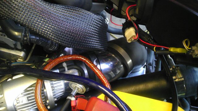

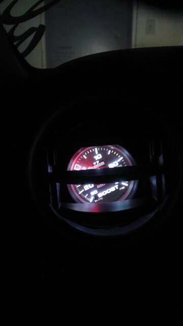

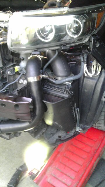

Everyone loves pics
Sent from my PG86100 using Tapatalk
Attached Thumbnails Please close thread, i will be closing my account. Thank You!-uploadfromtaptalk1333070843990.jpg   Please close thread, i will be closing my account. Thank You!-uploadfromtaptalk1333070859821.jpg   Please close thread, i will be closing my account. Thank You!-uploadfromtaptalk1333070878745.jpg   Please close thread, i will be closing my account. Thank You!-uploadfromtaptalk1333070897489.jpg   Please close thread, i will be closing my account. Thank You!-uploadfromtaptalk1333070913059.jpg

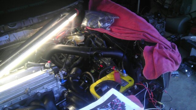

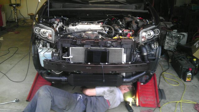

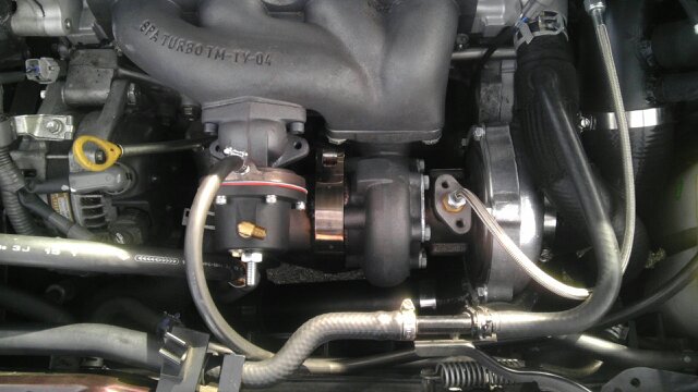

More pics
Attached Thumbnails Please close thread, i will be closing my account. Thank You!-uploadfromtaptalk1333070949969.jpg   Please close thread, i will be closing my account. Thank You!-uploadfromtaptalk1333070964424.jpg   Please close thread, i will be closing my account. Thank You!-uploadfromtaptalk1333070982190.jpg   Please close thread, i will be closing my account. Thank You!-uploadfromtaptalk1333071003340.jpg   Please close thread, i will be closing my account. Thank You!-uploadfromtaptalk1333071021345.jpg

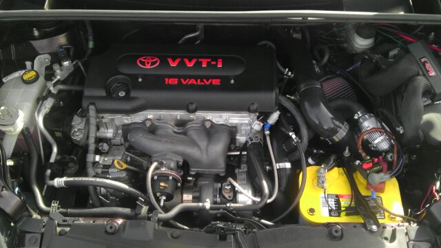

Posts: 140

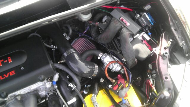

Attached Thumbnails Please close thread, i will be closing my account. Thank You!-uploadfromtaptalk1333071110471.jpg

Originally Posted by ThatGuyAtGeweke
More pics
why do you still have the trd box in and why are you still running uni-chip. nice build
