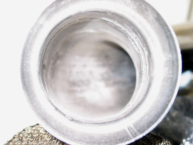

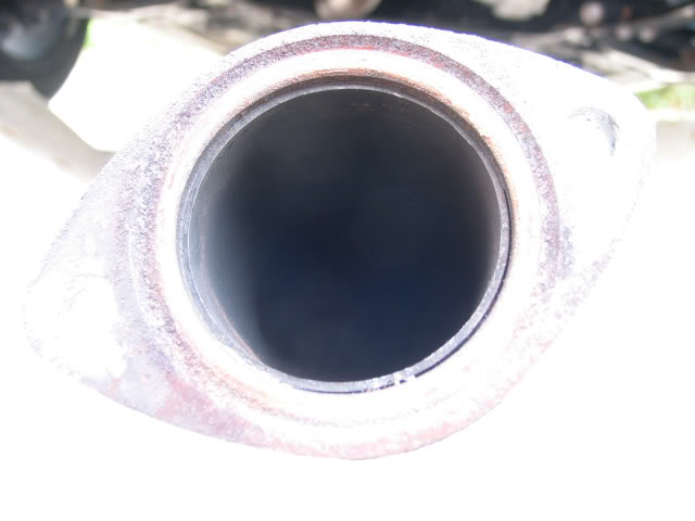

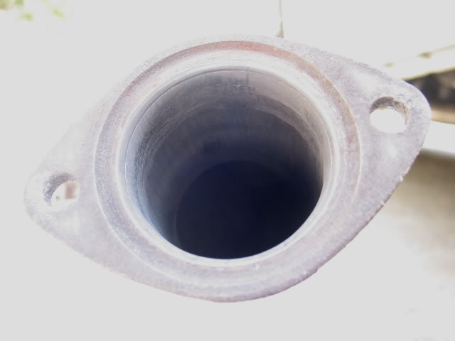

Probably a controversial move since it isn't cheap and I'm not certain what the value will turn out to be, but I'm curious having just installed a header. I already have a 2.5" cat-back exhaust, so I wanted to replace the OE 'S'-Pipe (2-1/4" entry half and 2" exit half) with a 2.5". I did some hunting, got pretty much nowhere, and decided to order a Weapon-R. So, now I'm waiting for it to arrive -- hopefully by Tuesday.
In the meantime, I might as well prepare for it. First, I wanted to evaluate constrictions in the final exhaust setup. Relative to 2-1/2", there's a very short 2-1/4" header exit plus longer "scuba" (OE resonator/main cat combination) 2-1/4" entry and 1-3/4" exit. I don't think the collector is long enough to have much impact, and the "scuba" exit carries much cooler exhaust gases that require less pipe volume, so I'm really not that concerned about either of those. The worst IMO is the "scuba" entry including the 2-1/2" to 2-1/4" junction, though with the gases already cooling a little, the temporary loss of 1/4" before they diffuse within the "scuba" is probably not as harmful as that abrupt size change. However, that I can do something about -- port the "scuba" entry pipe to smooth the transition. So, I ported the entry out to a smidgen over 2.5" and here are before and after photos.

Not perfect, but hugely better than before and very smooth to the touch (except for a slight dip where the pipe meets the flange). The "scuba" is now back under the car and ready for the new 'S'-Pipe.

Nice work Trevor. I'm surprised that there was enough material thickness to allow such enlargement to the scuba entry. While FromtheOld has a good point, I'm often inclined to take the extra time to tweak the little things like this. It may not produce a significant improvement but it's still an improvement. It's an individual decision as to whether the little tweaks are worth the effort or not. The time I spent port matching my manifold and gasket to my turbine housing may have been a waste but I don't regret doing it.

Fortunately, I only had to gain about 1/4", but the flange isn't super thick and I was afraid of weakening both it and the pipe in the vicinity of the weld. I ground it as far as felt safe and perhaps could have removed more, but the weld doesn't extend very far up the flange or down the pipe. If that flange were to break, it would be a major drag !
I switched from the Dremel to a drill with a cylindrical grinder bit and that was very effective -- it's a pretty large grind area. Finished off with 220 and then 400 grit paper. It's about a 45 degree angle at the outermost and pretty smoothly transitions to the inner pipe. Took me quite awhile, but should definitely help reduce turbulence.

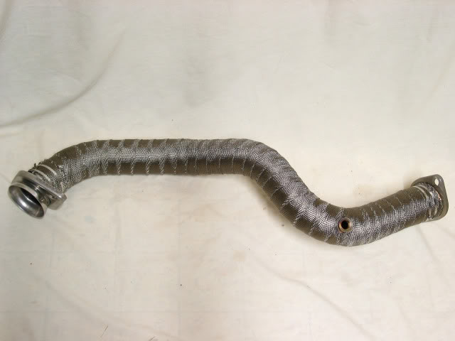

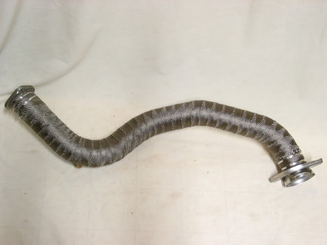

'S'-Pipe wrapped! Used 25ft of 2" wrap, got it as tight as I could, and used two 14" ties at each end. Might not look quite professional, but I think it'll do the job.
